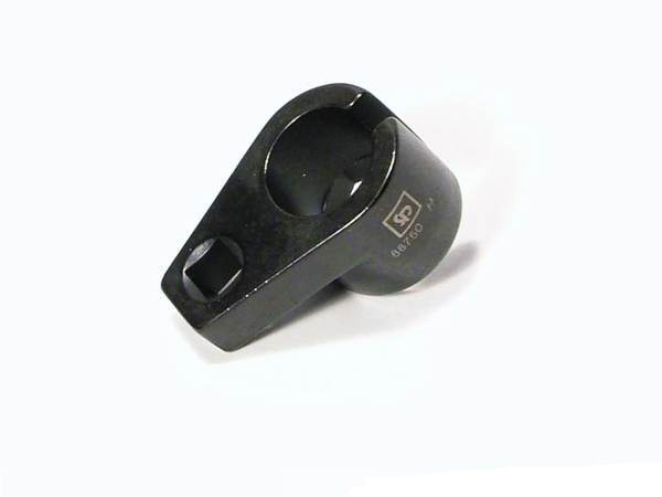

1. Get an O2 sensor ratchet tool, ratchet, universal joint, and long ratchet extension.
2. Unplug the O2 sensor. The plug is on the drivers side behind the coolant reservoir. You need to move the reservoir. It's 3 phillips head screws and just move it towards the front of the car to get access. I can't remember what color the plug is, but you have a new sensor so it should be the same color as your new O2 sensor plug.
3.There's a wire holder on the back of the head. There's no need to cut it, just undo it.
4. Take your fancy ratchet concoction and unscrew the sensor. You might need some liquid wrench to get it out.
5. Plug in your new sensor, run the cable the same way your old one went.
6. Drink beer.
Note: If you take out the oxygen sensor first, you can twist the wires and break them. So don't do that.
