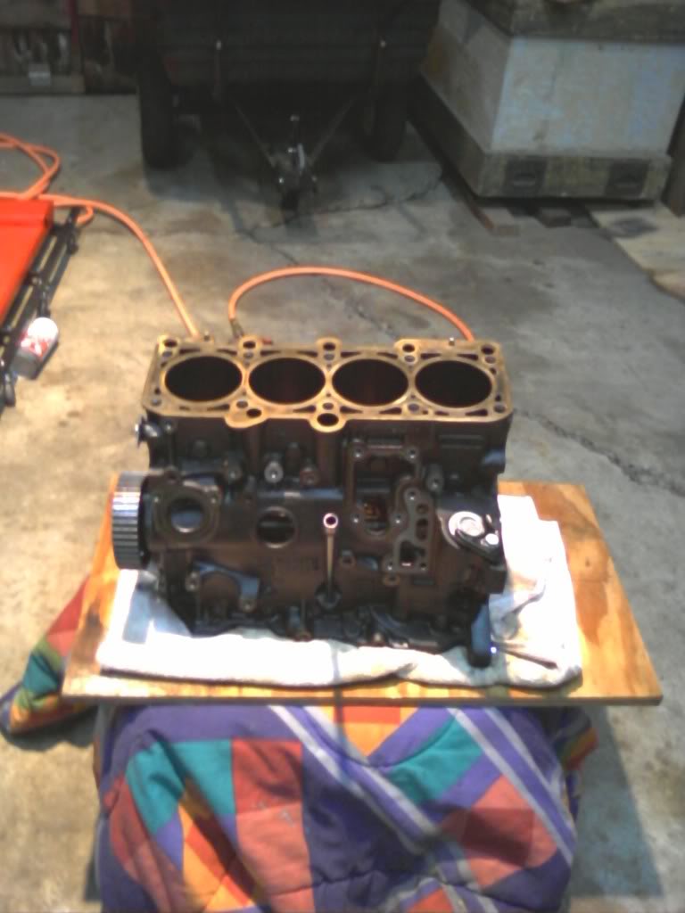

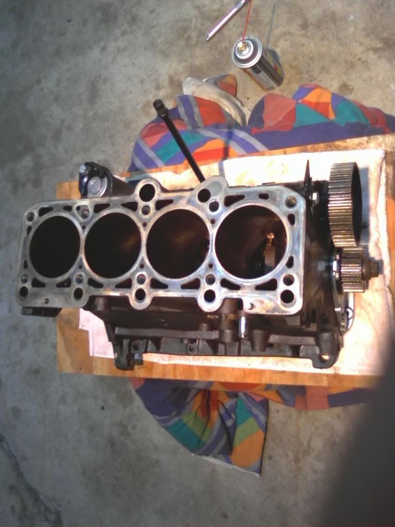

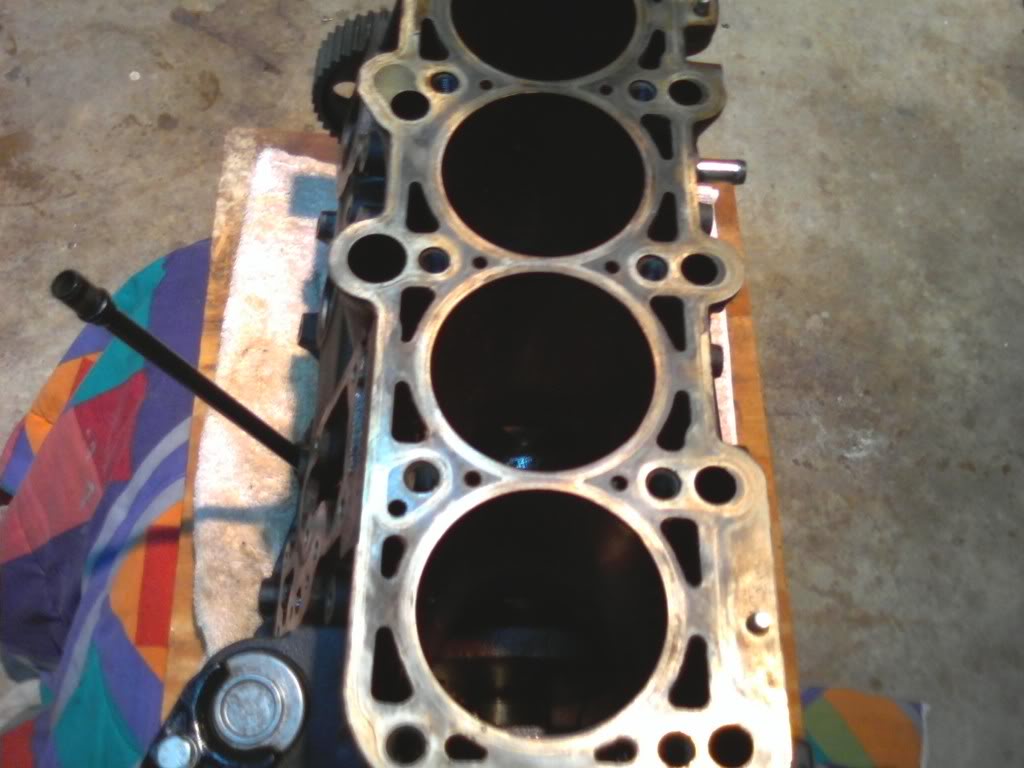

just finished cleaning it up. picked it up today from a guy off vortex. it was encrusted with road grime but physicly its in great shape. plans are to have it overbored +1mm and drop the compression ratio to 9.0:1. i figured if i have to replace rods to do what i want with the car, i might as well build a spare engine so i dont have any downtime. and of course if i have the chance i might as well increase displacement...

i havnt actualy purchased rods n pistons and whatnot yet. scatt rods are around $400, pauter rods are around $750, which of those depends on what HP numbers and turbo i decide on. pistons and rings are around $600 per set. im just reusing the stock crank which is why im not going 2.0L. i have no idea what they are goin to charge for the overbore/hone but they usualy steam clean the block before they do that anyways.
some signs of damage would be deep scoring or gouges in the cylinder walls, cracks anywhere, any signs of metal on metal contact. the crank thats in there turns effortlessly, no grinding/binding which is a good thing. same thing with the intermediate shaft.
if you really want to be sure you can have the block x-ray'd for internal flaws and micro cracks but thats not usualy necessary unless you are going for ultra high HP.

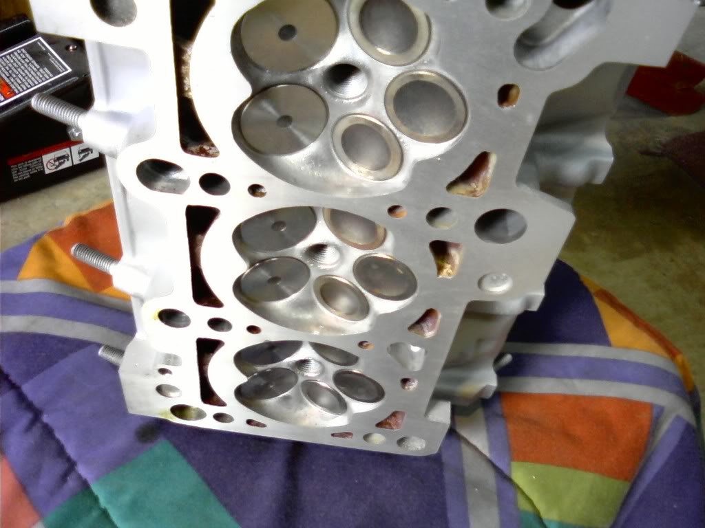

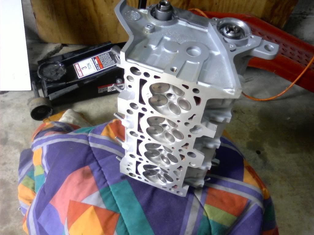

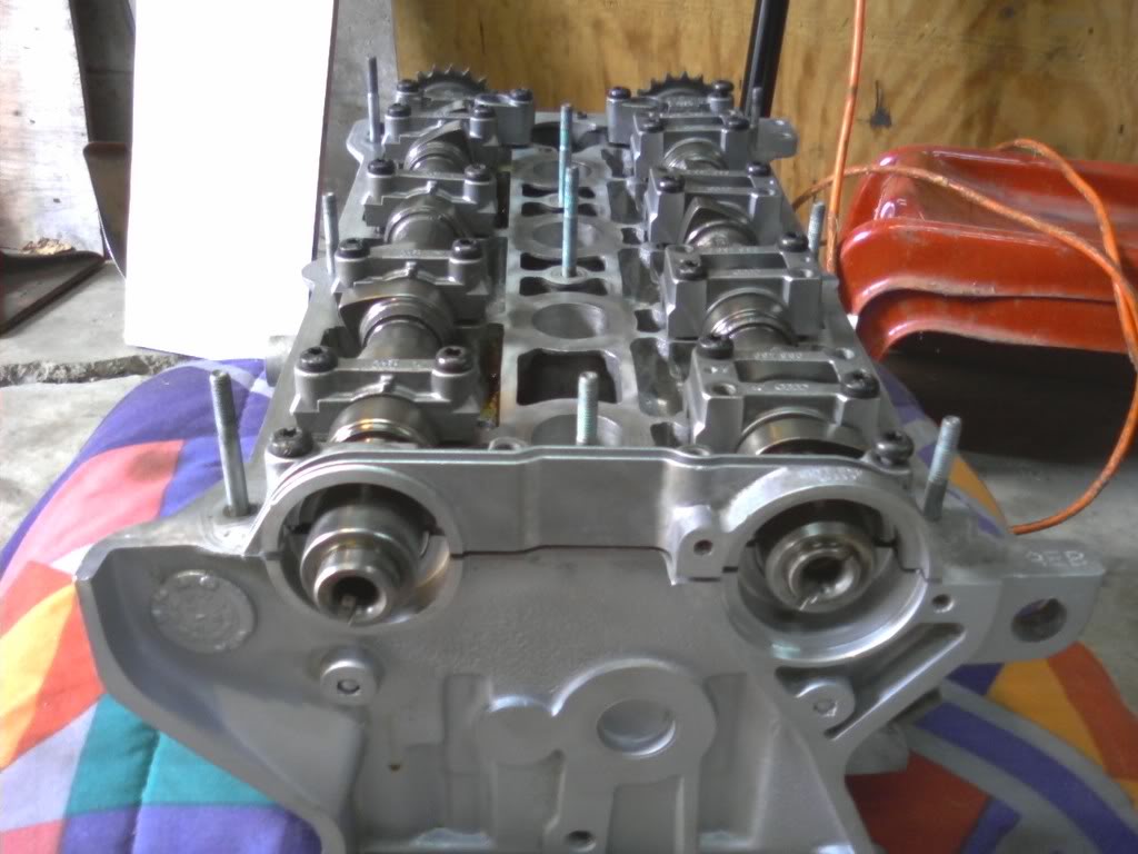

update... picked up a new head and cams, back from the machine shop, mild grind on the valves, opened up the bowl a little for some better flow. its nice and shiney
