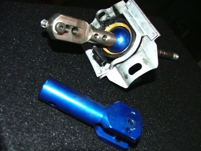

all those $40 ebay short shifters are ok. they are going to fall apart in a week, mine lasted for years- but thats not the problem. they dont replace the whole shifter reciever, the crappy plastic cup that holds that ball by two rubber bands. the JHM shifter replaces the entire thing with a massive bulletproof bushing. the shifter doesnt even have a mm of side to side play.
you can replace the center section all you want, but if you dont touch the rest of the shifter you wont improve anything. heres a pic of any ebay shifter installed in the stock shifter reciever they are all pretty much the same.
