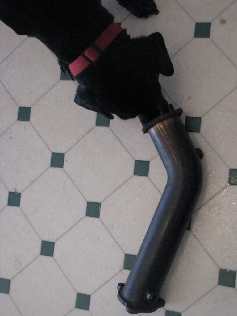

Ok, so first off, I bought the pipe used. The seller says it was off a 98 A4 with Quattro (it looks kinda like a b6 pipe to me, but whatever) but his reputation has declined for me. Regardless, I have the pipe now.

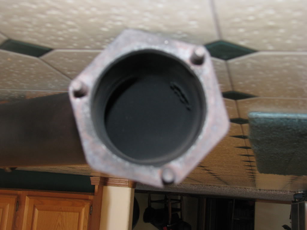

Three inch diameter both sides. My question is, will this mate with my stock exhaust? I know my DP is 2.25" and the turbo is 2.85" or something. I got gaskets, but they're for the cat, and thus will restrict the flow. Should I try to get three inch diameter gaskets, or will the 2.25" work fine? I want to do this right, not find out it makes all sorts of f-ing backpressure and resistance.

Its ok. Apparently my Autozone sells Help! ones. They need a tiny bit of drilling so the O2 sensor screws in, but its a good fit.

Ok cool, just checked the writeup on audiworld. They say to use the 42009 non foulers, but they also say the 42002 will work. I got the latter so I think I'm set.
Now for gaskets. I'm thinking since my downpipe and the gasket are the same size, I should stick with that gasket, rather than going to a three inch one as it wont seal well on the downpipe. Correct?
