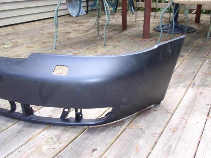

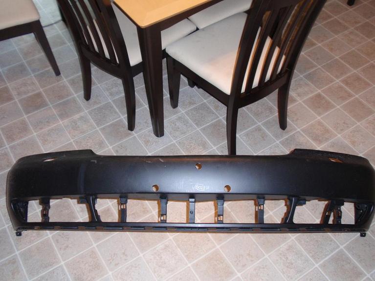

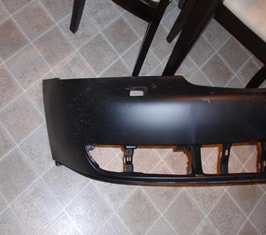

I tried twice more but theres something wrong it says that you don't have enough storage to receive the email so here's the pictures
Attached Thumbnails Radiator Support/ Fender compability?  Thanks.-p6250121.jpg   Radiator Support/ Fender compability?  Thanks.-p6250126.jpg

^ Is there a metal bumper behind that cover?

Posts: 3,274
Doesn't look like it. It doesn't even look like it has the plastic part that is usually connected to the back and gives the bumper skin support. If it was there you would be able to see it thru the head light sprayer hole.

no he doesn't want the support if you read the whole thread. Its just the cover.
