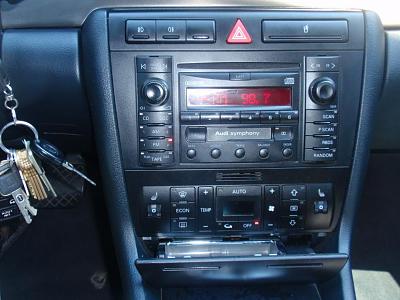

I have a symphony radio. I need to do some maintenance work on my car and for that I need to disconnect battery.
Now I tried to locate the radio card with code on it, but it seems like I teared it away for safe keeping. So the card is not attached to the radio manual and I kept it so safe that I can't find it myself.
Is there a way to retrieve the code without going to a dealer? My radio is NOT in safe mode right now. Thanks.
