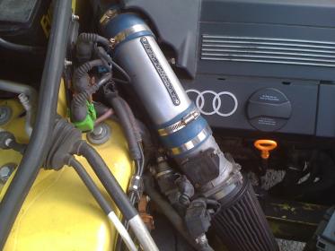

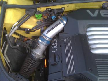

Here's my (crappy) setup

Yeah technically speaking, thats less of a "ram-air" setup than the factory air box. The factory set up uses a sealed airbox and a snorkel that pulls cold air in from outside the engine bay. That intake just pulls air from the engine bay, and while it sounds cooler and looks better IMO), it can actually produce worse horse power numbers if the air in the engine bay is really hot.
You could fab up a heat shield of some sort or another and try to get your hands on an OEM intake snorkel, or just go back to complete OEM if you want cooler intake temps.

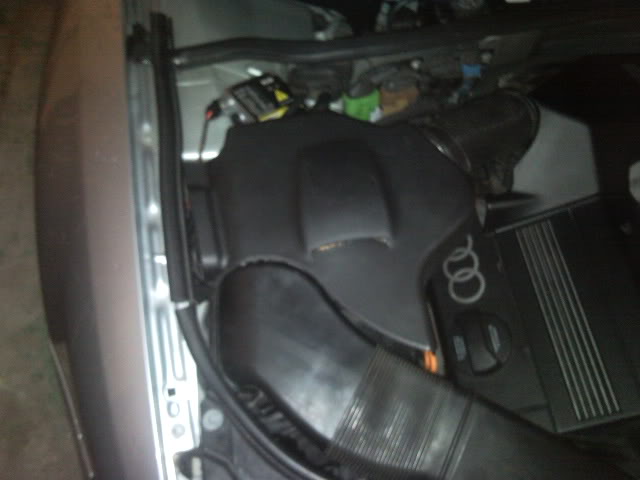

I'm not sure what Audi that came off of, but it wasn't a B5. Here's a picture of the intake setup from my 97 2.8. You can see the snorkel at the bottom of the pic. Its more flat than the one you posted in that eBay link.
The plastic thing on top with the air scoop that sorta looks like Texas is a cover, under that there's an air box that looks like this:
You're gonna want an air box like this one, but that still leaves you without the cover and snorkel. Check the classifeds here, on the zine, or vortex. There's always someone parting out a car and thats the cheapest place to find parts like these.
