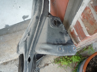

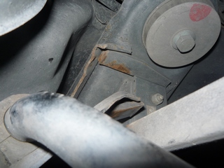

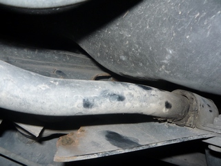

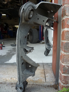

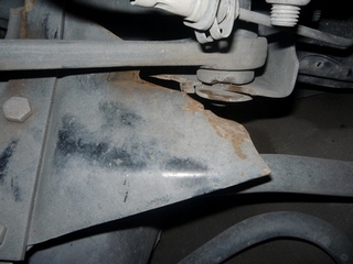

So I bought a 2000 1.8t 5 speed a few months ago and have done a bunch of work to the car to get it perfect.
It is at the local shop here and I found out that the rear subframe is cracked.
Previous owner's had installed a Neuspeed 20mm rear swaybar. Spoke to Neuspeed and they said that they no longer sell the 20mm sway bar they only sell a 19mm. And they recommend you purchase a hardware kit that comes
with additional plates that are welded to the rear subframe.
Apparently the 20mm bar was a race only item, not intended for street use.
Neuspeed also stated that all the A4 B5 subframes eventually crack even with stock sway bars.
Asked my mechanic about this and he stated that he had never seen a failure like that.
So a couple of questions:
1) Anyone with a stock rear sway bar experienced a cracked subframe?
2) Anyone with an aftermarket rear sway bar (Neuspeed or other) experienced a cracked subframe?
I got a used subframe and the $169 hardware kit to be welded to the subframe but it's going to cost $850 or so.
I guess it's better than having the rear end brake while driving...
Thanks
Andre

Default added pictures
added pics

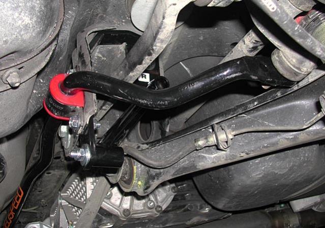

Seriously, I thought this was common knowledge, but sub-frames have cracked with a 19mm bar, let alone a 20mm or higher. Look at the picture(stolen from rob'saudiworld)...now think of the weight of the car flexing on that super thin part of the subframe. If you're going to run a thicker rear bar, you need to get the sub-frame reinforcement bracket period.
Attached Thumbnails Rear subframe cracked-PO had 20mm Neuspeed roll bar installed-installed.jpg
