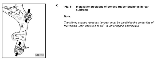

well since you mention it.. I AM an engineer. so i DO have an idea what im doing. I already know its Effed up under there, so I didnt want to take it and pay someone to tell me they cant align it because something is beyond spec.
looking at this figure I found Name:  subframe.jpg
what I am thinking is that my bushings got pushed beyond that 10 degree limit.
I will replace any suspicious components and get it into a shop.. I just didnt want to go throwing parts at the thing without trying to track down the problem first.....
