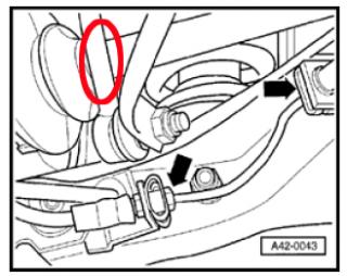

I double checked Bentley and I think everything is installed correctly.
I had to disconnect 3x suspension bolts on both knuckles, and used the floor jack to raise the suspension to driving height before torqueing down. Maybe this changed the orientation of the sway bar?

Wondering if I need to make spacers like these at the bottom of the page:
The Neuspeed rear sway Bar
Looks like the 96-97 B5's had skinnier end links.

Redmond I'm still trying to figure out what happened there. I poked my head under my 99 Quattro and the sway bar links really aren't that close to the CV boots back there. Have you compared the new to the ones in your trash can?
On mine, even if you put a boot on there that was bigger in circumfrence, the sway bar link is still a good 1 or 2 inches too inboard to come near the CV boot. On mine the sway bar link is over the axel itself, not over the CV boot.

What I find puzzling is that you say they're rubbing on the boots, not on the axle. If you look at that Neuspeed link you left way up above, you can see they rubbed on the axle. That's about where mine line up too, though mine are pretty far away. So to rub on the boot, either the new boots are much longer down the axle, or something is really wrong with the way you put it back together.
Have you compared the boots to the originals you took off?
