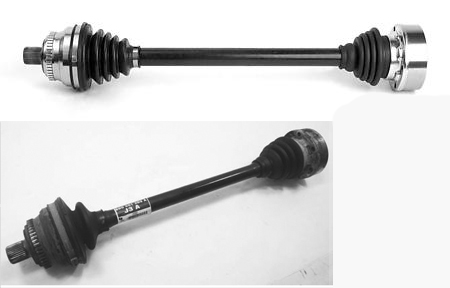

So here's a side-by-side image of the GSP aftermarket axle and an OEM axle. The outer boot on the GSP is larger.
Mtroxel: thanks for offering..

There ya go. The new boot goes down the axle quite a bit farther. I think if you put that CV boot on my axle I'd get some clearance problems too.

If you do, you'd better take their axles back with you. If you're in their shoes, I'm not sure you can do much except give your money back. Just looking at your pics, I'd swear the diameter of the axle is a bit bigger too. Just not a good part.

Good point. I'll have to rebuild my OEM axles and bring these back next weekend.
