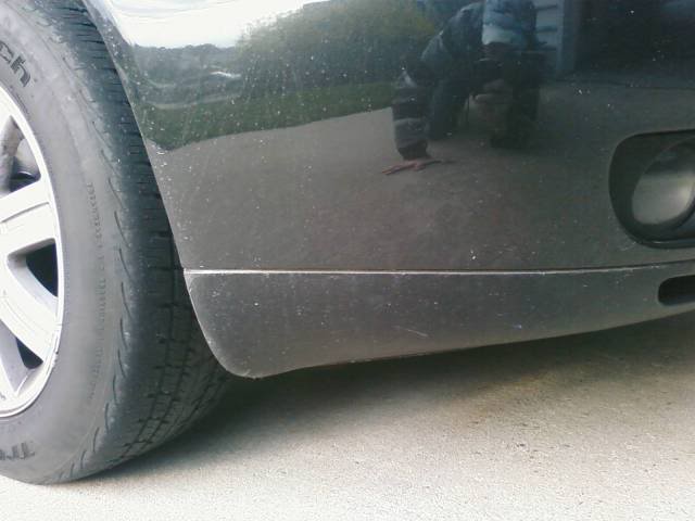

i was gunna repaint the piece of plastic below my bumper, because it has several scratches on it. im not sure how you remove it though; it looks like you may have to take off the tires first, maybe? amy help would be awesome!
^^the lowest piece of trim before the ground (below the fog lights)

its got clips it comes right off. it kind of a pain in the A$$.
Old Apr 10, 2009 | 08:46 PM
never_enough's Avatar
Joined: Feb 2008
Posts: 174
From: 49504
two torx screws on either side then just clips on the rest of the way around. it's hooked at about every 6 inches. just gotta muscle it off. make sure you prep the heck out of it so the paint sticks well. let us know how it turns out. are you going to do the rear and sides too?

yeah, i was planning on doing it the whole way around. i tried to muscle it off, but im afraid of breaking the clips somehow. i might just paint it on the car, and mask off around it.

i know it feels wierd but just yank it off. i just started mine and pulled for a while just go a little at a time. i think the "hooks"on the tabs are on the trim and then hook under whatever they go into under the bumper. you could push those down from behind if you want to be really careful. to do the best prep work you'll be better off removing it.

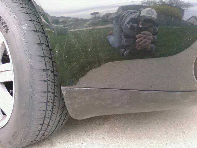

i just finished putting the skid piece back on. i sanded it down real good and put 3 or 4 coats of a flat black spray on it. I will post pics soon.

*UPDATE*
I finally managed to muscle the damn thing off. I sanded out the majority of the large scrapes and scratches from curbs, roads, etc. Then I primed and painted it with a flat black dulpicolor bumper spray. Sorry about the dirty car, haven't had too much free time to wash her.
ps. It may not look like a huge difference, but in real life it looks 10 years newer!
OLD
NEW

i was gonna say dont **** any of the side clips up, otherwise itll eternally be a pain in the ***. and im rolling without one for the moment to answer your question punchytable, it doesnt look gay its just not as tidy as before.
