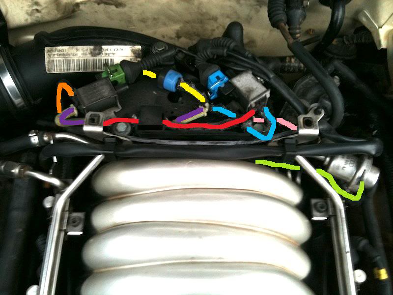

I bought some 3.5 silicone vacuum and 5/8" breather hose and I am going to replace it all. I will let everyone know how the silicone works for a breather replacement. I do have one question on a vacuum line. When I bought my car it was partially apart and I can't find where the vacuum line from the blue vacuum reservoir goes? If someone has a picture that would be great.
Not sure if this will help but someone colored my ripped up vacuum lines

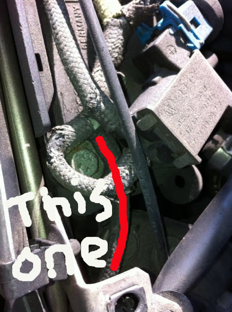

Do you know which one it connects to. It comes from the reservoir under the headlight and routes somewhere towards the firewall. I just don't see any that are missing a connection.
I can take a picture of that tomorrow if you remind me, pm me or something. I just replaced the vacuum line cause It was all cracked.
Thanks! I'll bug you tomorrow about it!
Old Apr 22, 2011 | 05:50 PM
  #20
IanWPB's Avatar
Joined: Aug 2008
Posts: 318
From: West palm beach, Fl
