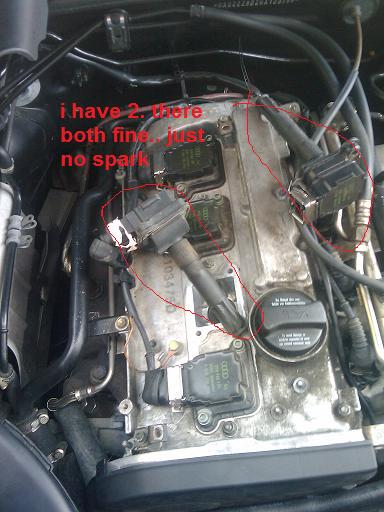

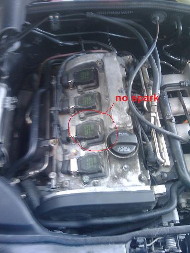

what is a coil pack and the ICM?
Attached Thumbnails Running on 3 cylinders,help!-2009-08-09-14.41.01.jpg   Running on 3 cylinders,help!-2009-08-09-14.42.33.jpg

No spark on #2 which is the one you marked in your picture is always caused by the ICM(ignition control module). It is the black little box that is bolted to the top of your air box and has a harness connected to it. The ICM is well know for going bad and 99.99% of the time its the part that controls cylinder #2 coil pack which is the part you showed pulled out of the head in the 2nd picture.
Picture of the ICM and where it is located.

There is nothing you can do, it needs to be replaced. The ICM controls the coils, basically tells them when to fire. The part of the ICM that controls the coil for cylinder #2 is know to go bad, when this happens you need to replace the part.
