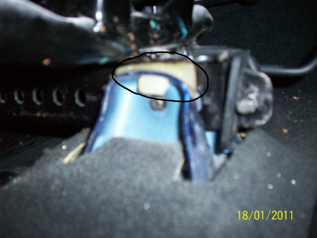

Originally Posted by sadik666
Your issue is that your missing a small plastic piece who should sit at the beginning of the middle rail. That plastic piece is use to align the lock pin with the hole on the rail. I know it because I had that piece missing after my car went to a complete body restore and the guy at the body shop lost one of the piece when the remove the seats and I end up with the exact same issue. The piece itself should'nt cost more then a couple bucks.
If you have no idea what piece i'm talking about, I can try to take a picture of it.
Im thinking its this also on the pass side but looking at the pics. of the drivers side id say who knows.

How is the plastic piece called?
How does it look like?

Here's where the plastic piece is suppose to be ... I tried to take a picture but it wasn't clear enought to post it ... I would have to remove the front the seat to take a clear picture ... I have no idea how you call that part ... I'll will try to remove my seat this week so I can take a clear picture

I tought I can post the picture I took even if they are not really clear ... maybe it can help you ... and by the way, it's more of a rubber piece then plastic.
Attached Thumbnails Seats loose-pic_1.jpg   Seats loose-pic_2.jpg   Seats loose-pic_3.jpg
Just as a data point, if you grease the contact points of this plastic thingy, it would allow the seat to slide back and forth MUCH easier. I just did mine after suffering through needing to get out of the car to adjust the seat forward for many years...

Use white lithium grease for all moving parts, including rail, pin, spring, lever.
I am still looking for the plastic insert for both sides. This would at least put the passenger side seat decent shape (currently moving quite a bit and requires 'wiggling' to get let the pin snap in. Couple of times, the passenger moved all the way forward with this heat under hard braking).
The driver side will need the plastic. Wish I could get my hands on the factory parts (not the butchered bracket). But with the plastic, also the driver seat will be more fixed (the play it currently has is irritating).

This is the part that you are looking for.
http://www.ecstuning.com/Audi-B5_A4-...r/Seat/ES4769/
