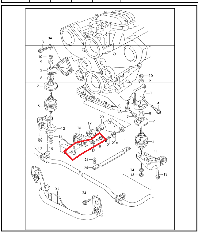

Self explantory. I replaced my motor and snub mounts today. This included me getting it in the service position for the first time!
Well, the driver side snub mount bolt wont go back in. I can't seem to catch the thread of whatever's in there. I can see the threads so it's not totally stripped but they do look irregular.
Also, whatever i'm trying to bolt it into is moving!
Did I break something in there? Any ideas about getting this thing back in?
ONE bolt left to do in the whole job and I can't get it!!!

sorry if my post sounded mean, wasn't intended. but maybe some pictures would help. the snub sits on a rod thats mounted in the lower left hand corner of the engine. AFAIK it doesn't bolt, mine slid on with some pressure. when you put the red shroud back on it has a cage it goes in that will mate up with it.
savantv Jun 13, 2012 09:30 AM
1 Attachment(s)
first, thanks for clarifying your response.
Second, based on what you said I'm referring to what you're calling "the cage". The photo below shows the bolt I can't get back in. Thanks!
Attachment 29158
jonbonesjones Jun 13, 2012 09:33 AM
ahh thats the cage, but your cage should be round? mine was and i have a facelift? confirm that but that bolt should just thread into the rad support if its not, then something is stripped out.
savantv Jun 13, 2012 09:50 AM
exactly, i'm trying to figure out what that something is. My cage looks like the one in the picture.
The bolt doesn't bolt directly onto the radiator support. There's some kind of bracket or clip or something *inside* the hollow of the rad. support.
I don't know how to get at it.
IanWPB Jun 13, 2012 10:28 AM
Can you use a flat head to line the threads?
99.5's don't have round cages.
jonbonesjones Jun 13, 2012 10:46 AM
then why is my cage round ian? jw is it aftermarket?
