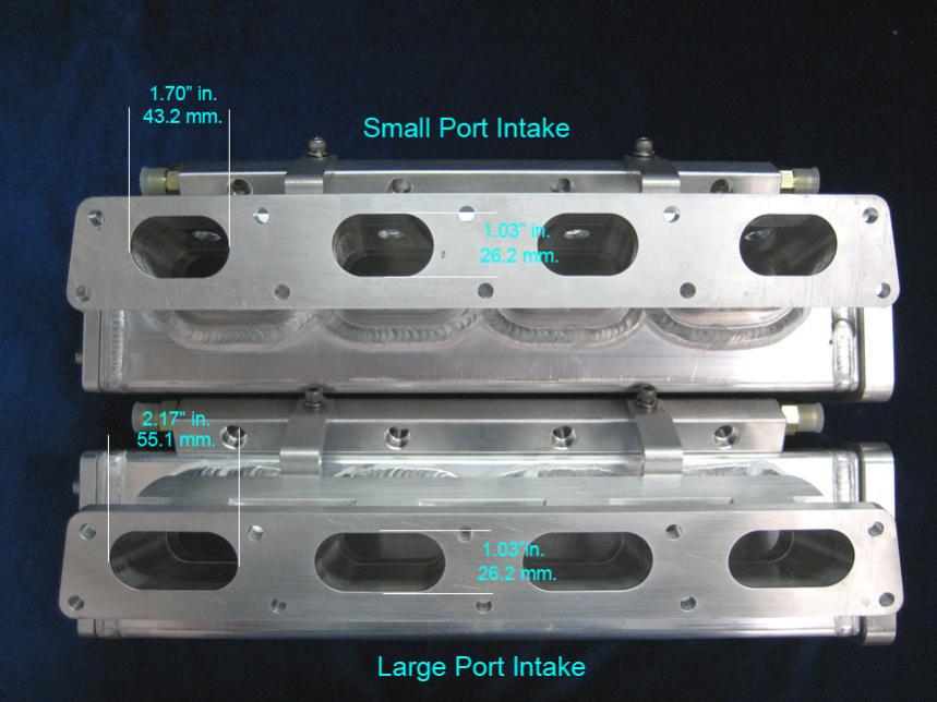

You looking at the 1.8T or 2.8? If you're going for a car to tune, try to get a 99.5 with the 1.8T. I didn't know it at the time when I bought mine, but the 99.5 was the last time they used the AEB engine which has the much larger ports, allowing for a better flow, and more HP in the long run. Plus the 99.5 has the facelift with 1 piece headlights, clear side markers, new tails, and upgraded interior.

Yes, the 2001 has more stock HP due to an upgraded turbo (K03s), but that's where it all stops. If you want to upgrade, stick with a 99.5, if you want to just chip it and call it a day, the 2001 would be great, because it's newer and probably fewer miles on the odo.
I was looking for this pic earlier to show my point about the AEB engine being able to flow better, and thus produce more HP in the long run.
In the end though, these are just my biased opinion, afterall, I have a 99.5
