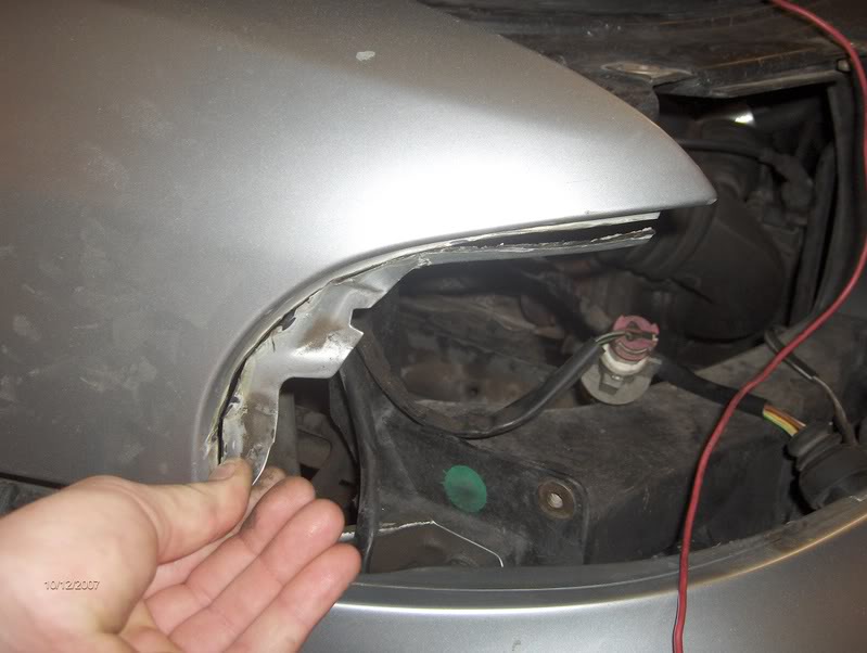

Why do they remove the bumper in the write up? I dont get it he says he removes it to pull out the old headlights but you dont have to remove it to do that.. Does it need to be removed for the dremeling? And does anyone have some pics of what to dremel? Thanks

This is the section of the fender you will need to remove with a Dremel tool.
