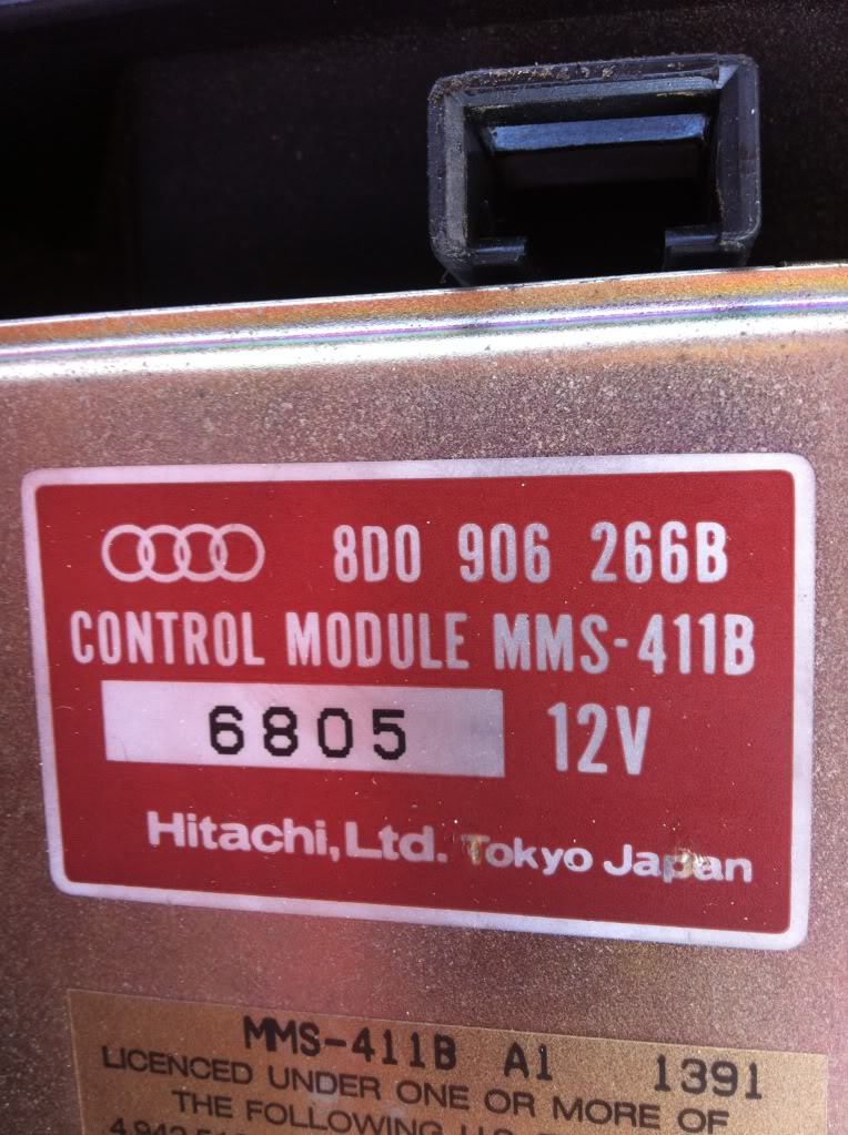

Alright I finally made it up to the shop to snap a pic of the ECU, please advise

I have that same ecu code in my garage. Thought I had a bad one and it was something else. I just tried swapping it into my 96 12v and it started right up and I have a 266A ecu stock. Shoot me a pm with a reasonable offer and it's yours
