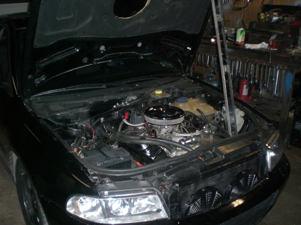

Old Mar 22, 2010 | 01:19 AM
  #60
mikekey's Avatar
Joined: Nov 2009
Posts: 911
From: Saint Petersburg, FL
old school
LS1 going into B5
Now thank you, I am watching that thread very closely, that would be a fun project.
