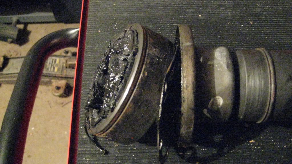

I received Blauparts' center drive shaft rebuild kit sometime at the end of September. I've had limited time to tear down my own car recently, but two weeks ago I had the chance to at least replace the two end joints, which were very easy. As for the carrier bearing and center u-joint, I couldn't figure out for the life of me how to remove the bolt in the center. Once I discovered I would need a press for the carrier bearing anyway, I decided against replacing these parts for the time being.
The result: I cured a vibration around 60-70 MPH. But it STILL clunks!
The rear end joint was stuck to the rear diff companion flange with an ungodly force. Prying, pulling, Zep Twister, cursing, and some beating with a dead blow eventually separated the end joint from the flange. The above pic is what I found. The grease was shot and had dirt ingrained in it. The joint itself felt sloppy compared to the front. I f anyone is interested, I can post a write-up of how to replace the center drive shaft end joints.
Replacing the center drive shaft rear end joint was definitely needed as seen in the above picture, but the CLUNK iS UNCHANGED! ;(
