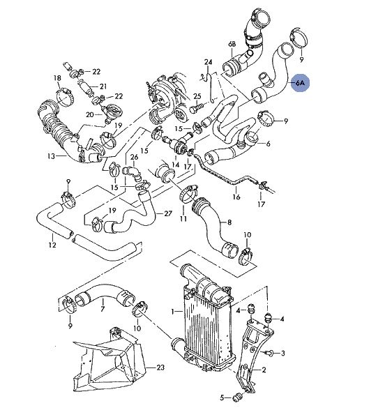

i am trying to find the hose that comes from the turbo and connects to the diverter valve, bottom of turbo and to the long metal air "thing" in the front bumper. anyone know where to get it or a part number? my belt chewed mine up..thanks all

No the one that goes from the turbo outlet to the metal pipe that carries air to the intercooler. The little elbow hose.

#13 is that rubber intake hose. Are you looking for #8 that goes from the turbo to the upper connection of the intercooler as shown in the picture below? If so it's 4B0-145-838 for 98.21 dollars and takes 3 days to get to us here on the west coast, then 3-6 working days UPS ground out to you. Add about 10-11 dollars shipping also. Any questions please ask. Thank you, Jeff. (Disregard the blue highlighted circle, it's the way that photo was saved on my computer.)

So i believe hes talking about hose 6 on the diagram.
