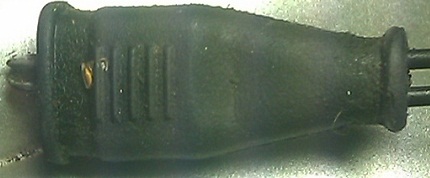

I just did an engine swap (AHA 2.8l) and I have one unknown harness plug. Anyone know where this guys home is? It is on the driver’s side, up front by the harness cluster near the power steering reservoir.
The wire is long; it could reach to the passenger’s side. Looks like two black wires (no colors I see). Looking straight down on the connectors (there is just two male pins), the plug is rectangular and it has no clips.

It doesnt plug into anything, it is the outdoor temperature sensor. It mounts on a little stand right in the front lower center of the bumper and is visible from the lower grille.

It doesnt plug into anything, it is the outdoor temperature sensor. It mounts on a little stand right in the front lower center of the bumper and is visible from the lower grille. You can actually pull off the rubber piece at the end and expose the sensor itself.

Thank you, I would have been fighting a long time to find that one.
