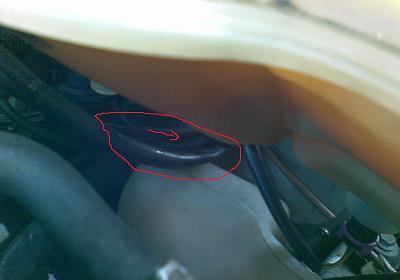

The sensor seems to be fine. And I just found out some cables under the expension coolant tank have some green coolant(see pictures).
Since I have mixed the original G12 with green coolant, the coolant in the transparent expension tank is neither green or pink, it has no color. How come coolant on the cables is green? Would it be possible that since I have accidently spill some green stuff out when I refill it. But it was a such long time ago(the coolant could remain liquid on the cables for few weeks?)...

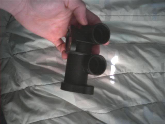

mixing the green in with the pink probably didnt cause a leak, but its still not good to have in there. the leak could be coming from a number of places but heres what the part they were talking about looks like.... (one of the two holes on the top has a sensor in it, the other has a plastic plug)
Does anyone know what is the problem?
Thanks very much!
Those pictures you posted seem to show the area right underneath the overflow, which would be wet if you splashed the coolant around while adding it to the reservoir. It is also where it comes out if it gets hot and overflows. If you havent been overheating, then it is probably just there from splashing it around the rim while you are filling it up.
I dont have overheat yet, but the coolant level always drops.
