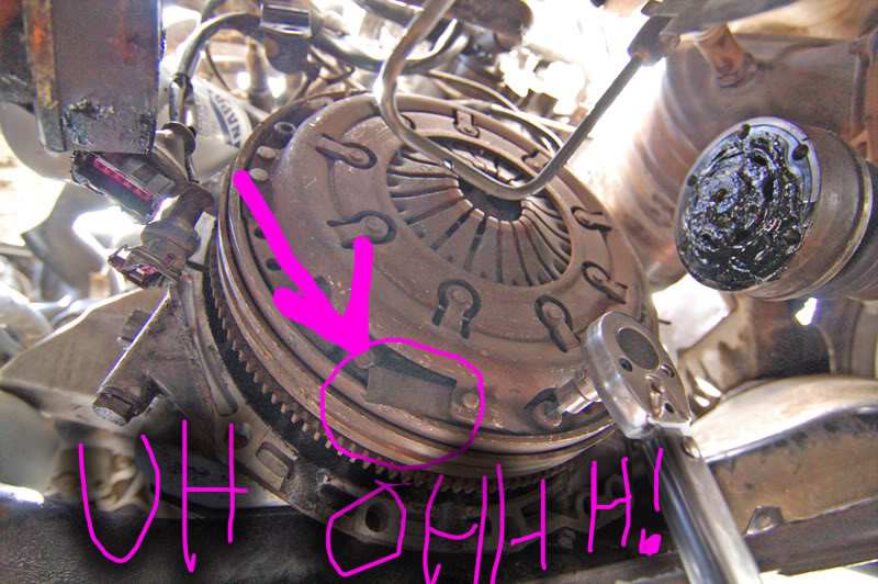

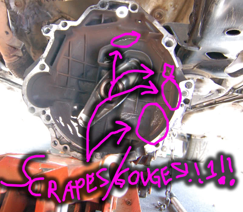

you may have something like this going on....

Originally Posted by 99A4NOW
I think I know what that is. I had a spring on my clutch break. The spring was like a metal strip and when it broke it was still connected on one end while the other end began cutting into the transmission housing. I caught it in time as to not cause any real damage, but let it go long enough and I suppose it could cut your tanny in half. I use to have pictures of it somewhere... I'll see if I can find them.
That is the flat spring, I have had that happen to me twice now when the pressure plate cracked into many pieces from it being heated up by the disk slipping.
Problem with this is that would cause noise all of the time not some of the time since the spring would be hitting the housing every time it rotates. This can do major damage to the bell housing.
