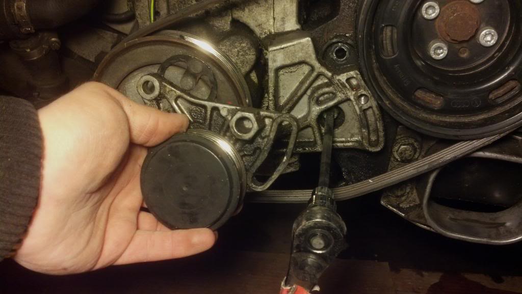

Originally Posted by AudiTurbo
thanks
Where is the tensioner located?
Its at the very front. It's shown in the picture below. This is for an AEB 1.8T motor.
