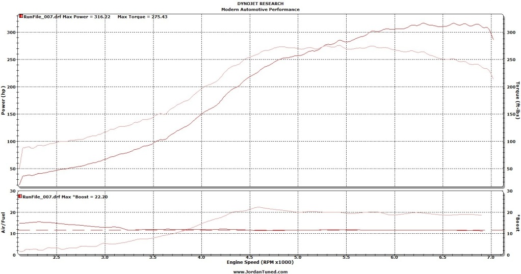

a main problem with the a4 is to get good times and good power, youll need to upgrade the turbo. but th bigger turbo coupled with our small displacement means a sacrifice in low end power. heres my dyno graph. I run a 2871r. note that I'ma only at 200awhp at 4350 rpm. my hotside is a tad big for the turbo, but you get the idea.

Not bad numbers at all. Honestly I just want the low power of the k04 and to maximize it to its full potential even if that means I little bit of weight reduction and E85 with full bolt ons
