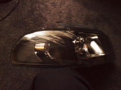

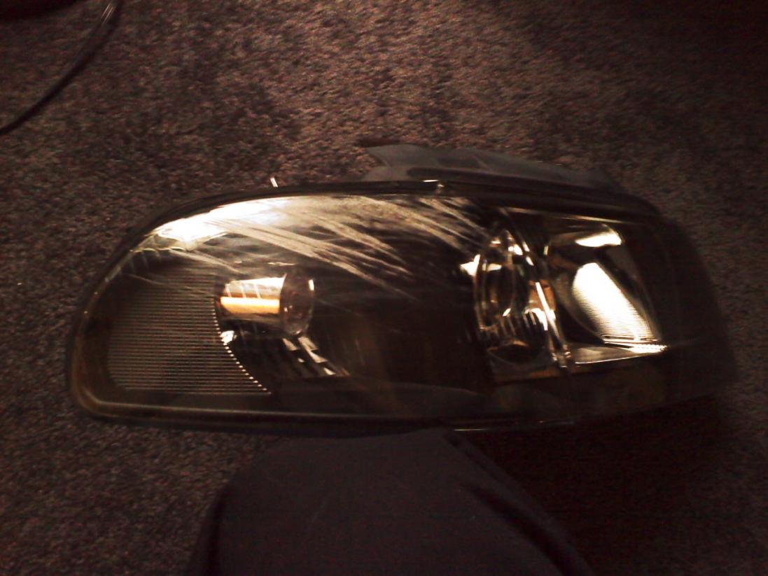

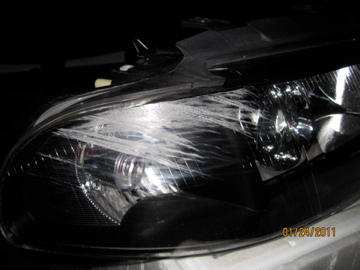

i found some headlights for sale but one of them has a big scuff on it and i dont know if some wet sandpaper and polishing would fix it or not. give me some of your opinions

Hard to tell from the pics, but it would depend on how deep the scratches are. If you can get them really cheap it might be worth it to buy them just to see. If not you can always do the best you can with the scrape and then sell them lol

the guy is telling me that its just scuffs and that there isnt any scratches on there. and yes they are very cheap.. only $80 shipped. should i just pull the trigger on that deal?

Just looking at that first picture you can tell it's a scuff. A buffer will take that right off.

Wet sand with 1500 then 2000, buff and polish and I bet you'll be good to go.
