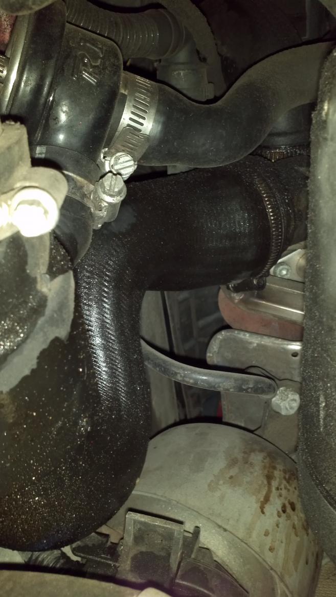

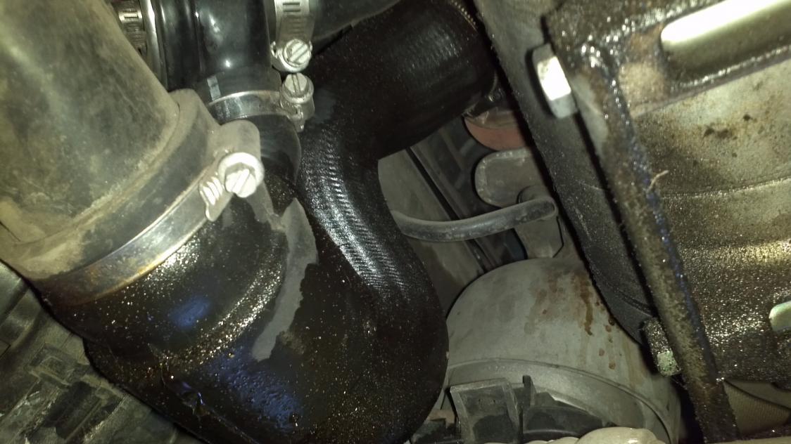

Also, I've found that my turbo is leaking oil pretty bad onto the hose that runs down toward the belly pan... safe to say I probably need a new turbo right? If the whole unit needs to be replaced should I upgrade? I should also add that on the fwy if I punch it there's a lot of surging, like the turbo is slipping (don't know how else to describe it)

It sounds to me like you've got a bunch of different **** going on. The oil leak you're describing could just be a loose banjo bolt on the oil drain line coming out of the turbo. Usually when a turbo has blown shaft seals, the oil leaks into the intake and/or the exhaust creating white smoke or filling the charge pipes with oil. If none of the oil is leaking into your TIP, exhaust, or any of the charge pipes I don't think you need to replace the turbo. A pic would be helpful here.

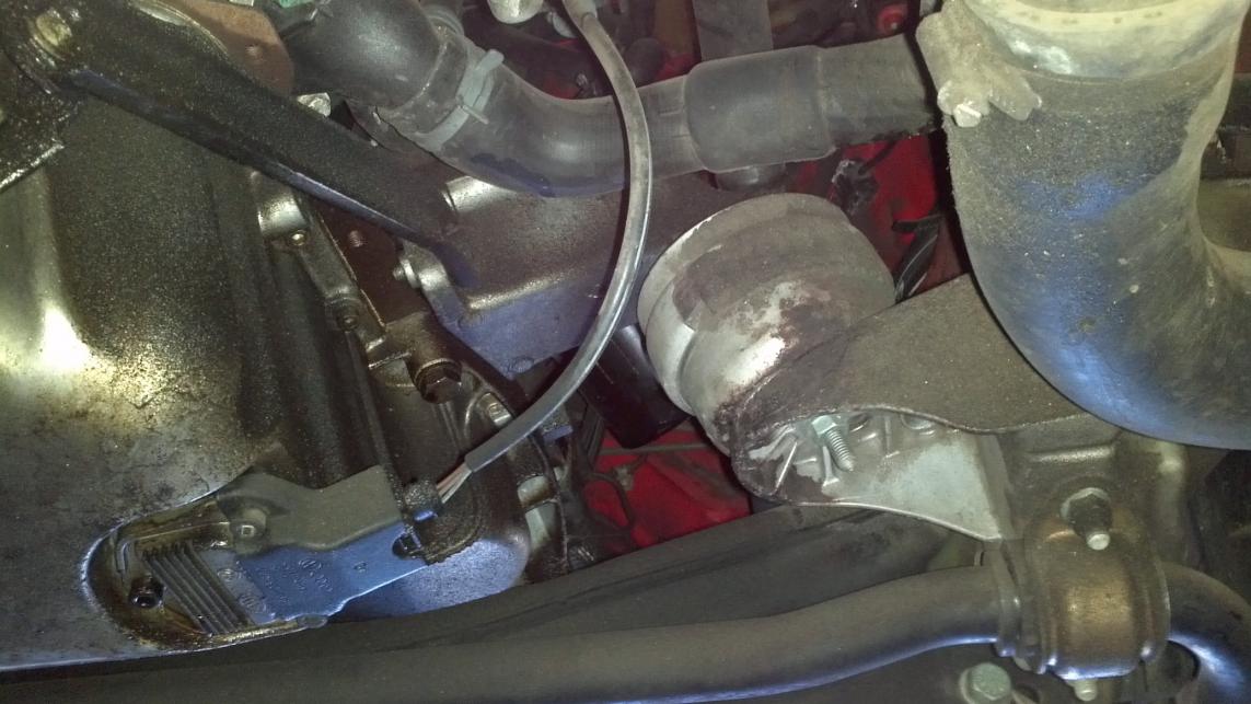

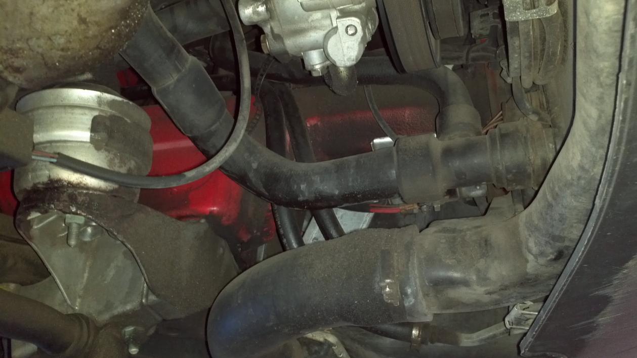

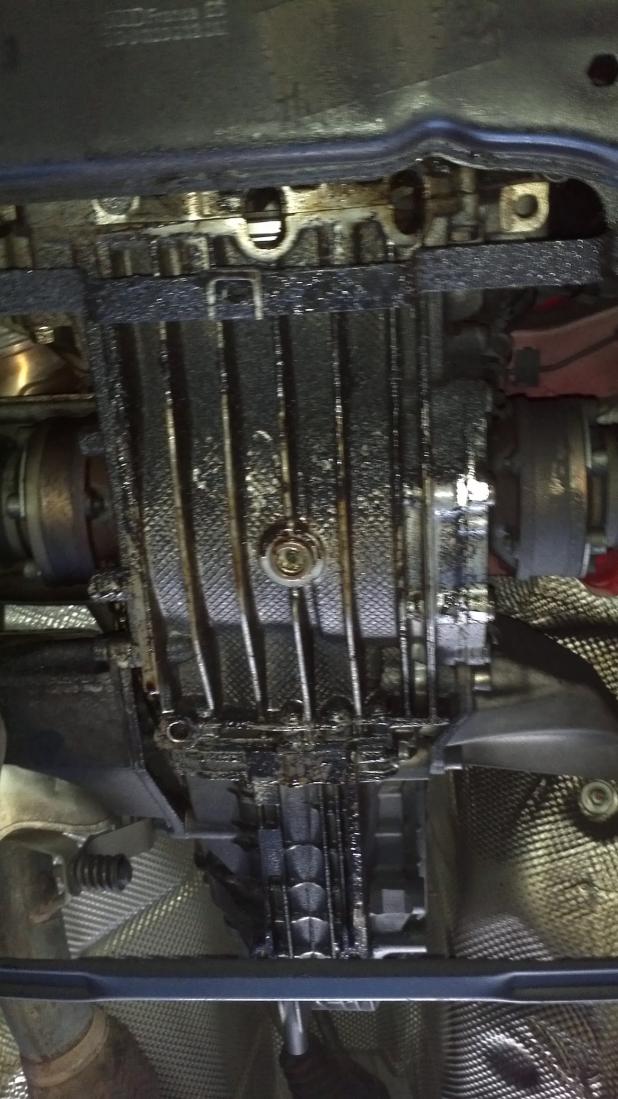

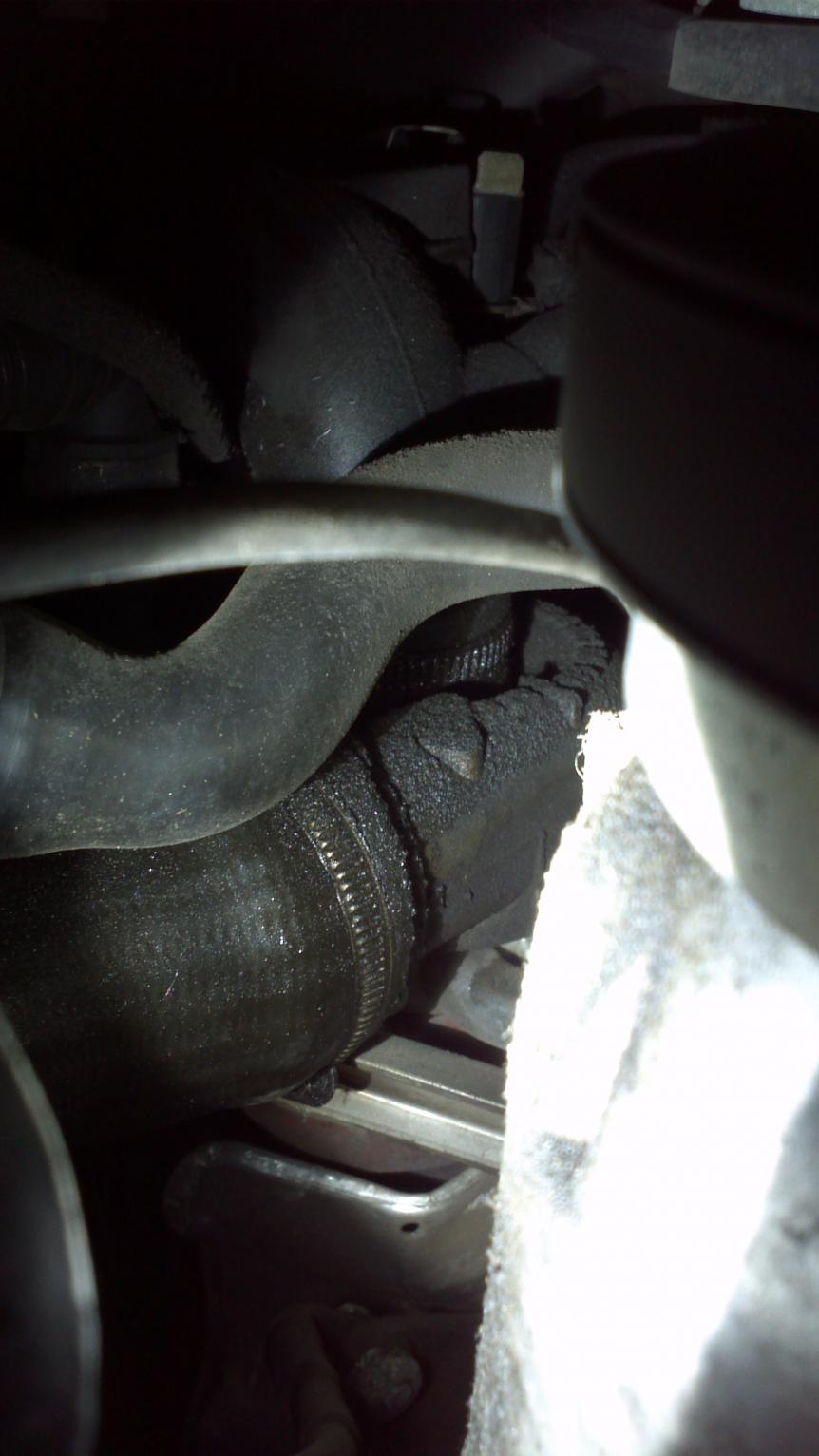

here are some pics

@CCA4, I have the APR R1 diverter valve and from what I remember it only comes with one spring and isn't adjustable. From what I saw (you can see them in the pics) the motor mounts look ok, maybe the slop I've been feeling is the snub, I have a new one that I bought about a year ago and never installed it. It will definitely go in when I do the timing belt job.

these are all taken from the front of the car looking back, the first 3 are the oil leak/diverter valve/passenger side. the next two are of the drivers side, some oil and the motor mount. and the last one is the oil covered trans cover.
