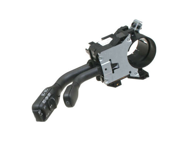

Do I need the whole electrical switch? Like this:
Or is there something else that I need?
I'm unfortunately just going to have to take it to the Audi dealership today because I have work tonight and must have them fixed. So instead of paying $122 for diagnoses, I just want to go in with the ability to tell them exactly what it is that I need.

No, don't do it! I'm guessing you can pull on the stalk to engage your high beams but the lows won't come on. That's the piece but if you follow the DIY below you'll thank yourself. Probably too late by now.
AudiWorld Tech Articles
1 hour tops for a first-timer taking their time with all the right tools.

^That fix helped me for about a week before my lights didn't work again. I ended up taking the wheel/switch apart 3 times (trying new contacts) before I installed headlight relays to actually fix the problem.
