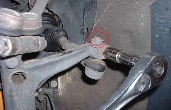

Also, I have a small concern... As I was looking at my tie-rods I noticed something is missing in reference to this picture, please advise me if this is normal or I should be concerned (The picture is not my car, I lost my camera >.< the pic is from the AudiWorld Tech Article on the PS Rack)...
The bolt that I highlighted in red is missing from both of my tie-rods. There's just a hole! Is that normal???
