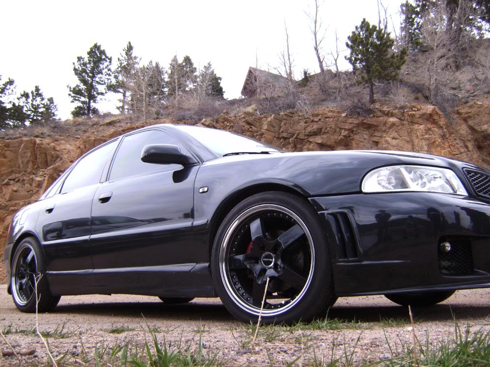

look up falken koblenz, pretty sure these are 5 spoke and they come in Audi fitment
edit: someone out here runs them in black
