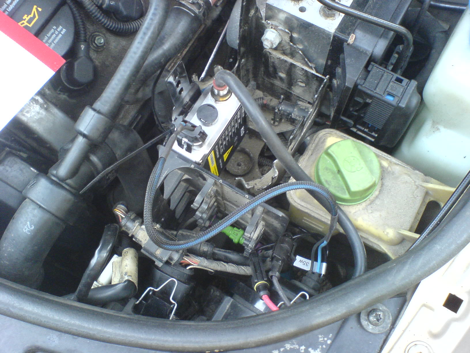

here's a pic of my driver's side
i mounted the driver's side with the screw for the airbox because i took my airbox out. you can also mount it under the headlights with zipties. you can probably mount it inside the airbox while using the airbox without trouble, the airbox doesn't really get hot and the ballast isn't really big enough to obstruct a large amount of air flow
that works too! hey that ballast looks very similar to mine..
