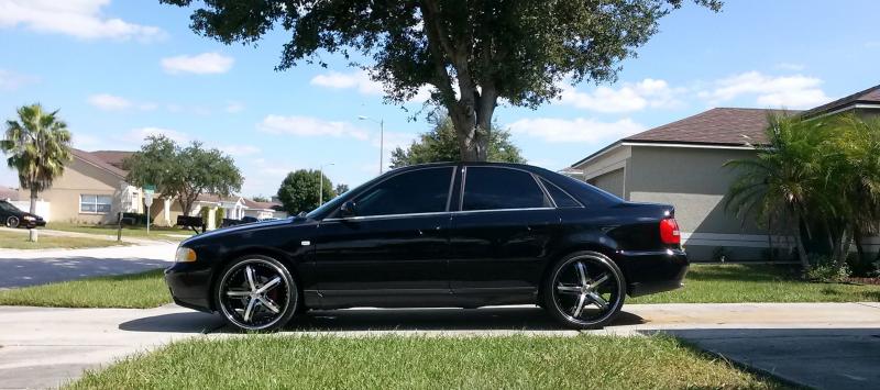

I used a 235/30/ZR20 tire profile on 20"x8" wheels, keeping my overall rolling diameter within (roughly) 3mm of stock, so it only rides 3 millimeters higher than stock. This should also keep the speedometer correct.
The offset has only a 2mm difference from stock, so they don't "stick out".
As you can see: Aside from being 1" wider, the wheel specs are nearly the same as my stock wheels.
Ride quality: Even I thought the ride quality was going to be rough, especially since my car has the sport package - but to my surprise, with the correct tire pressure and new front end steering & suspension components I used, the car rides almost exactly as it did before the wheel switch (not bad at all).

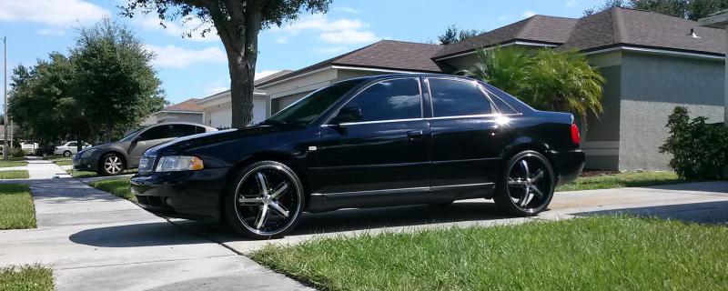

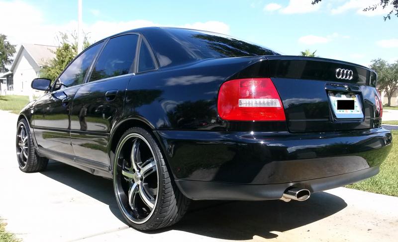

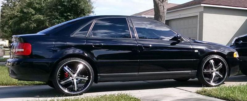

As for looks: You tell me if they look "Ghetto", or whatever:

Everyone will have their own opinion, of course.
My opinion: for the most part, 19" is almost too big. I say that because some wheels can pull it off, while others... can't.
I ran 19" wheels on my B5 with 235/35/19 tires for about 8 months, as they came with the car. The car was on a mild drop (~1") with Eibach springs. Let's just put it this way: I got really good at pothole avoidance.
If you are asking for opinions, I don't think it looks right. Wheels are too big and too ostentatious for the body lines of the B5. I think the wheels demand too much attention away from the body. And honestly, I think it looks kinda like a Volvo now (particularly last pic).
At least you're pretty close to stock size (I calculate your speed would read 63.5 MPH when actually traveling 65 MPH).

I've defiantly seen worse 20s. They don't look terrible but it's not my cup of tea. I always liked 18s with a bit of a drop on b5s. I run 18x8 with 255/35/18 originally but have switched to 225/40/18 since then...better ride and the tires aren't painted on so potholes aren't as big of an issue. Also it makes the brakes look horrible (tiny). You can always tell "poser" "donk" rides with big rims...all show. I makes me think of ricers who run 100hp cars with big wheels, body kits, wings, graphics. But underneath its still a shitty ricer. Just my 2 cents. But keep in mind there's a car scene for just about everything, so while some people give you **** others will love it...and remember you opinion is the only one that matters, if you like it that's it.

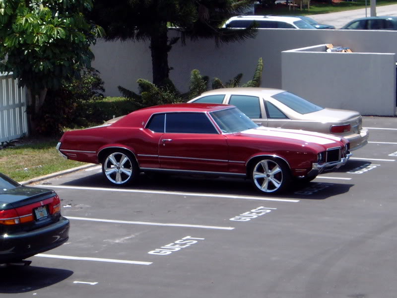

I'm from the deepest part of the south, where "DONKS" have existed prevalently - longer than I, or the horrible name "DONK" have.
I used to put "DONKs" to sleep with my "DONK-ish" '72 455ci Cutlass - Hand build 500hp/600fp Ziegler racing engine - everything forged) with a Turbo 400.
It was far from "A lazy attempt", but esthetically, it was definitely "loud".
See here:

You've confirmed the "ghetto ness" but hey who cares what I think it's your car if you like it that's all that matters.

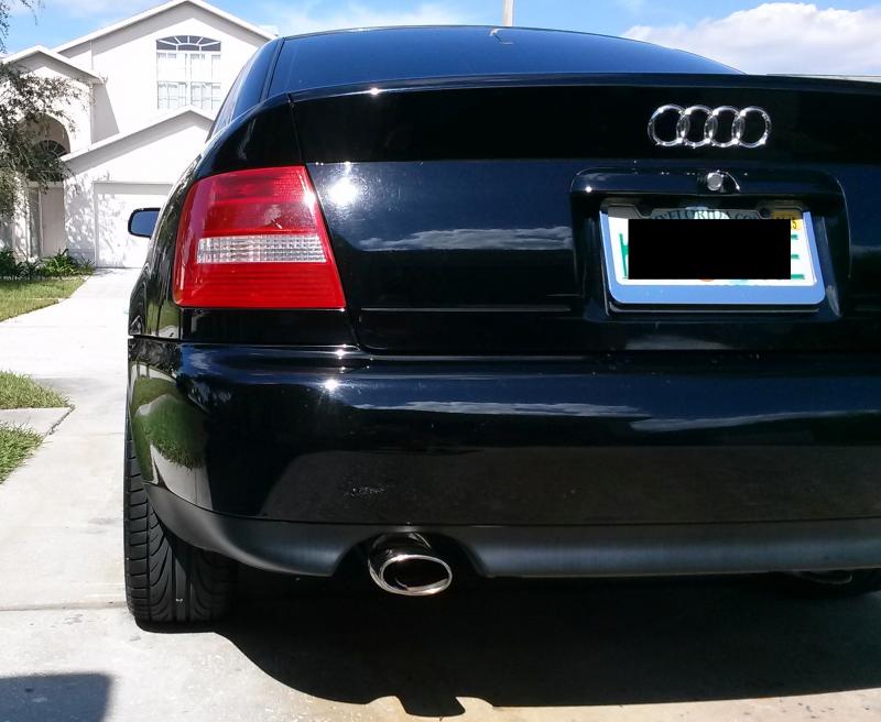

Can you post a picture of the rear end straight on? I'm trying to decide if I want to debadge it and just leave the rings like it looks like you did.

Are you sure your car has the sport package? Because it looks taller than the average non-sport B5.
Massive rims, rubber band tires and ground clearance. You have 3 of the main ingredients of a donk, just not as much oft hem as a full-on donk. It just looks wrong, the proportions are all kinds of messed up. But it's your car so do what you want, this is just the opinion of a random Canadian.
As for the ride height: It does have the sport package (yes: I'm sure) and the overall rolling diameter is no more than 3mm more than my stock 16" sport wheels, which is < or = to an increase of 1.5 mm in ride height. That means it's still sitting lower than a stock (non-sport) B5.
It's probably the appearance, mixed with your bias that's making it look like it's siting higher than it really is.

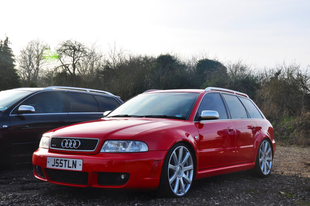

Personally, I would never put 20" wheels on a B5. I think 18" is the perfect size.
That said, it can obviously be done and in some cases done really well:
Your A4 is not one of those cases. I think those rimz are hideous. Nice Cutlass though.
