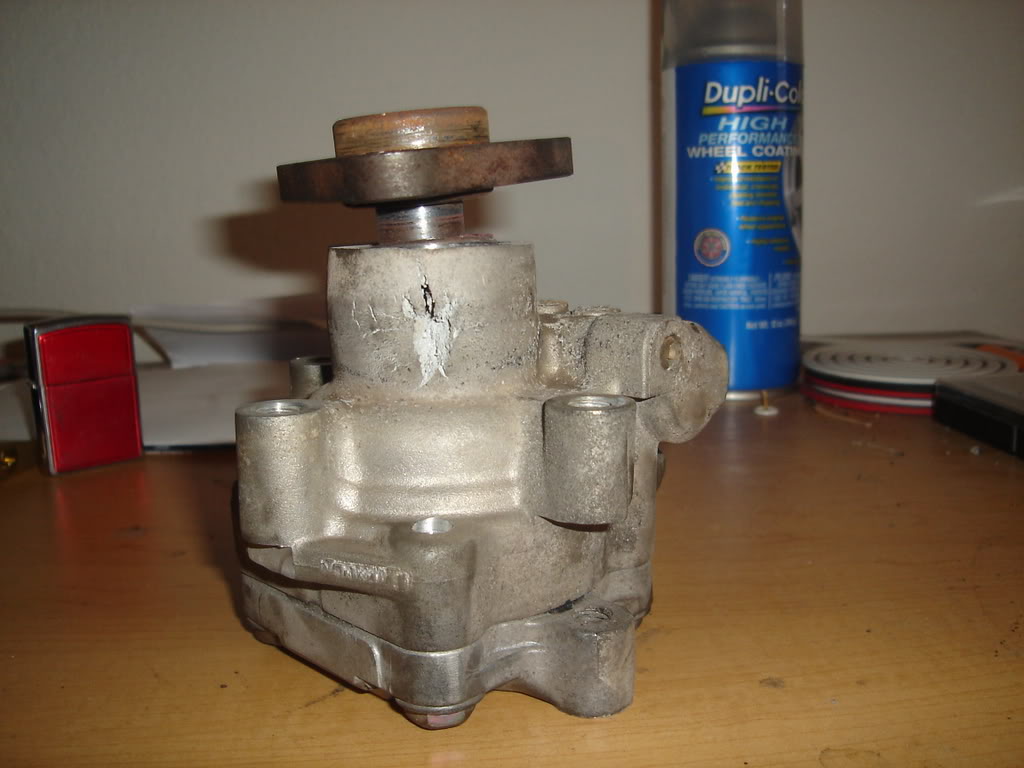

So long story short, my power steering cooler got mangled and started leaking ps fluid while i was driving back to tallahassee. i thought it would be fine to keep going and that i would just not have power steering. WRONG! costly mistake on my part. here's the damage
the ps pump's shaft that connects it to the pulley got bent, throwin the whole belt and shutting off the car (at 80mph)

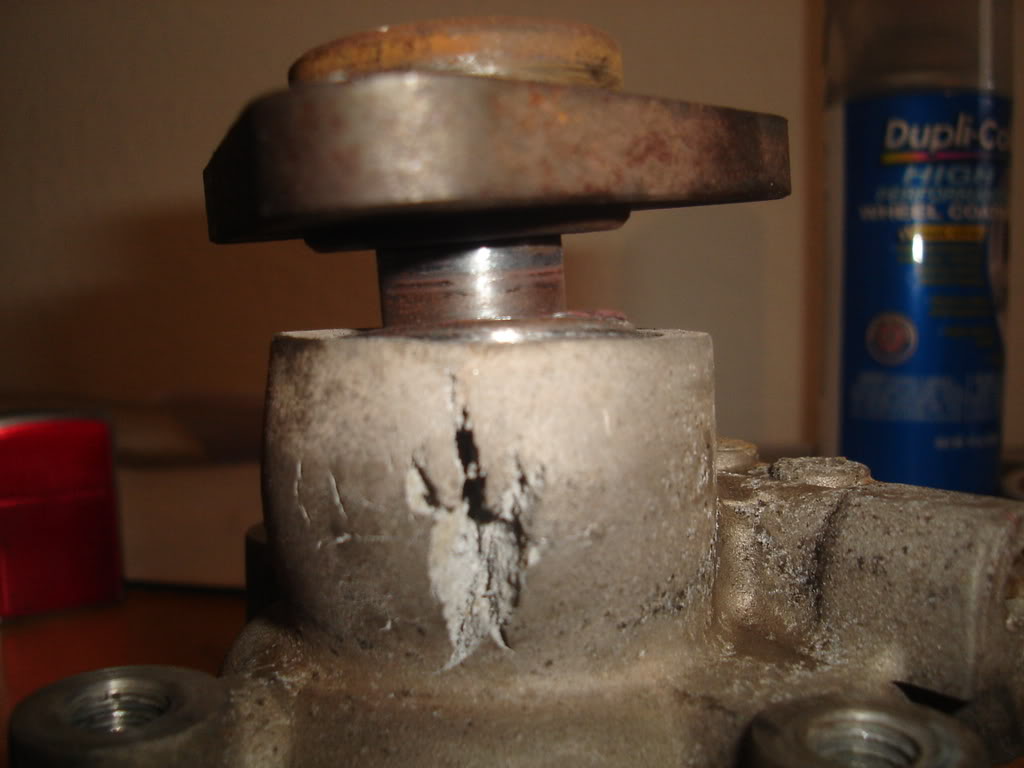

see that nasty chunk missing too? here's a close-up

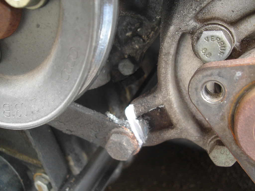

it also took a nice chunk out of the cast aluminum piece it sits in (luckily didn't go all the way through and barely missed a bolt)

so i ended up needing a new pump, cooler, 2 belts, and ps fluid. dealership tried to rape me for over 400, and if i let them do it, close to a grand including labor. eff that. 100 bucks, 6 beers, and 2 hours later, its done.

and yeah i was surprised at the extent of the damage too. i showed it to Auditech and he said thats the first time he's seen that happen, and that was only when i knew about the bent shaft.
and i have a few random nicks in the cast aluminum pieces surrounding the pump. i dont even get how they got there, or how a huge chunk in the ps pump was taken out. but oh well. live and learn
