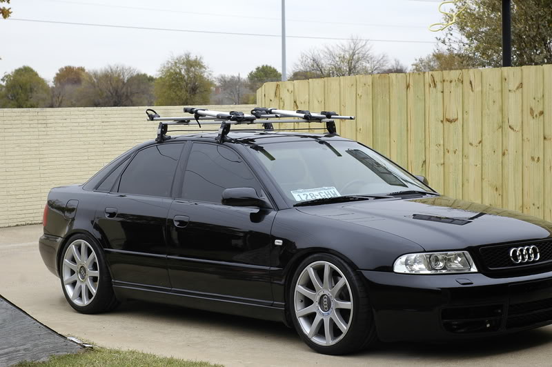

Here's the look I'm going for

^ I believe that car is running 18X8.5 with 235's.
Why not go for 18's instead of the 17's?

How do you want the wheels and tires to sit? Do you want to poke at all?
Usually 8.5 wheels come with ET35 and you will sit somehow flush.
