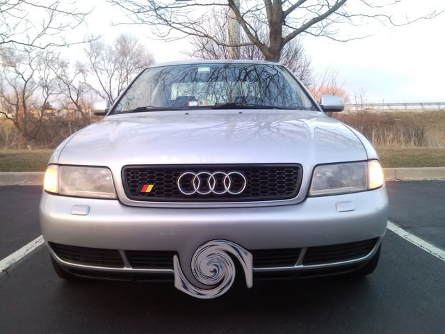

The sprayer nozzles should be pretty apparent on the hood. There's two bumps on the hood, each one has two jets in it. In the pic below you can see them pretty well on either side of my inspection sticker.

my spray nozzle is not on the hood like yours CCA4, which is weird lol.. I've had this car for 2 months and noticed my hood was a different color so i figure it was a different hood
