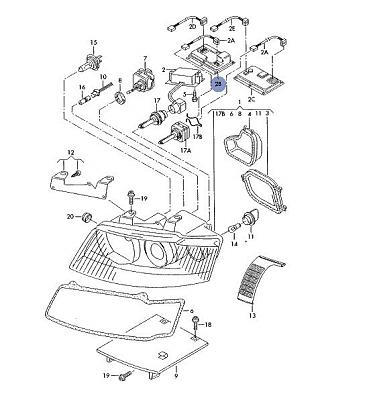

For your car 2b and 2c ballasts are the same part number and only one used per headlight. Two are shown on the picture for some reason because of a vin # split that doesn't really matter in this case. It's p/n 3D0-907-391-B retail at 507.00 and 377.21 internet price. 17a is used into model year 2002, but around mid year 2002 and on 17a is used. It's N10566103 and retails for 160.00, internet price like somebody above was very close to, is 119.04 dollars. For early year 02 cars the #2 is used and seems to have the mate to the connection to the early style bulb 17. But the parts guide doesn't call #2 a ballast, instead it's called a control unit with ignition device, in other words "igniter", I suppose it's the same thing. Anyway, there are some of the differences for your car and year, part numbers and prices to give you a heads up on what your are looking at.
