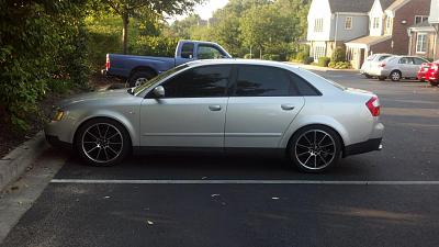

So I've just begun modding my '03 A4 1.8t Quattro and I'm looking for some direction on the best path. At this point I'm happy with the look but I need more power!
What I've got:
Unitronic Stage 1+
Borla Exhaust
18x8 Wheels
JOM Coilovers
I was thinking my next moves would be :
Upgraded DV or BOV (mines still stock)
Test pipe
FMIC (Godspeed?)
Intake heat shield
K04-015??
I'm not looking for crazy power at this point but enough to make the car more fun to drive. As it stands powerband seems to stop around 4500rpm and it seems to lose power after that. I'm sure the FMIC will reduce that power loss in the higher rpms when the intake temps start cooking. Any info would help or info would be appreciated.
