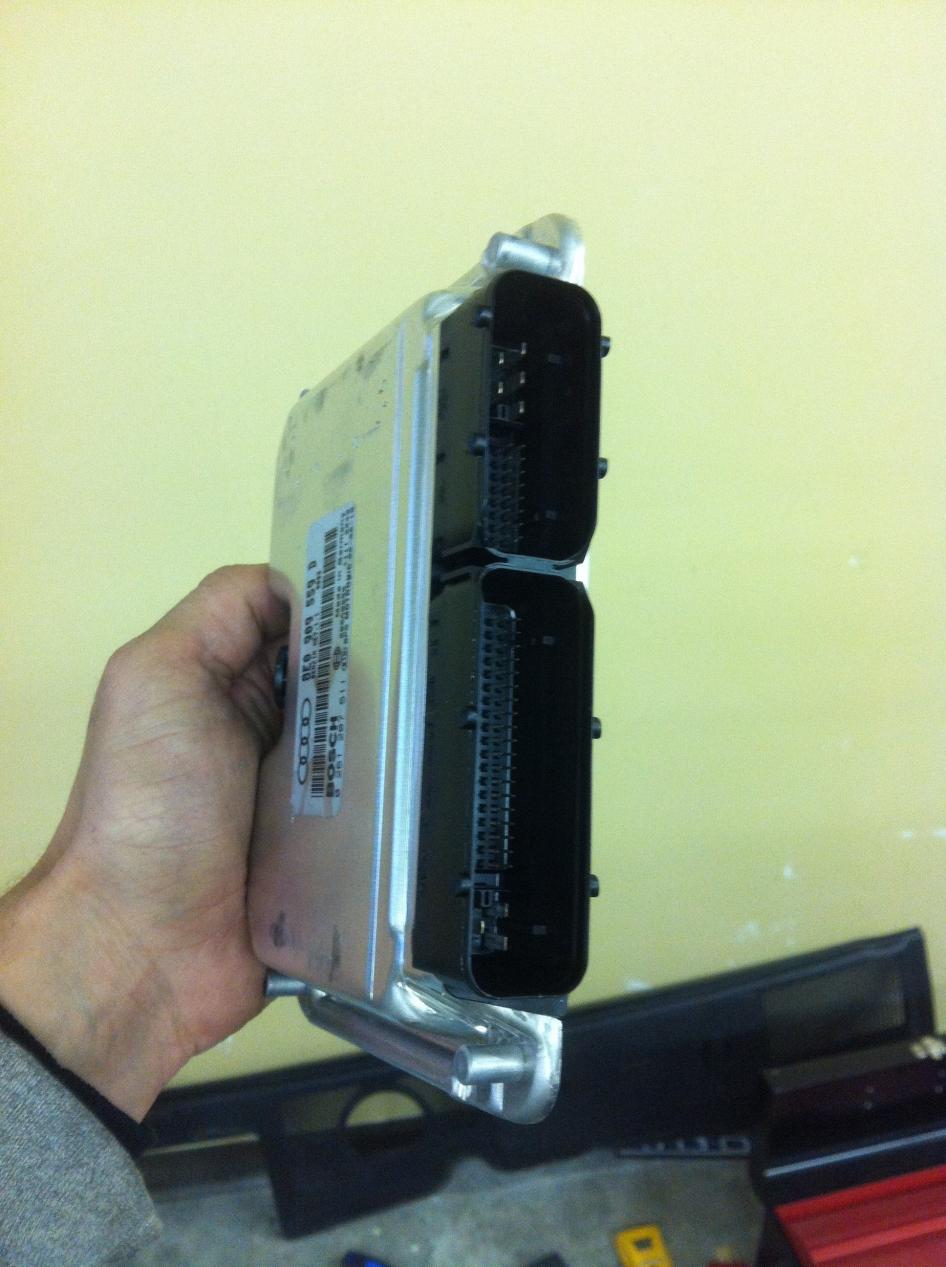

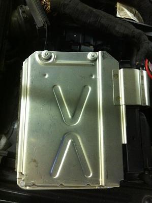

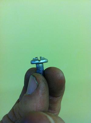

Well, so short of changing the ECM and reflashing, I read that if you disconnect the two harnesses connecting it all the adaptation values are erased (though not the DTC's). I'm thinking maybe because the change over valve broke the adaptation values got way out of whack and because it was driven that way for so long it will be hard to get back on the straight and narrow.
So I did that. The ECM is unfortunately under a security bracket so you have to dremel out a slot to torque open with a flathead. Took 3 arms (1 to hold the screwdriver down and turn it, one to hold the ECM, and one to clamp a vice grip on the head of the screwdriver for added torque. They loctite that thing pretty severely). Thank you a4mods.com (http://www.a4mods.com/index.php?page...tml&category=1)
I'm gonna sew her back up and drive around for a bit tonight and see if there's any change at all. Hopefully I didn't hose myself somehow.
Still open to other suggestions. But good luck Stephen with the heads. It's a brave job and try to remember any gotcha's in case I have to delve there myself!
BTW what is the OFFICIAL audi repair manual? ElsaWin? Bentley Publishers? Something different?
Thanks!
1940: ECM under the security bracket with the two sealed bolts toward the top.
1943: One of the dremeled bolts.
1945: ECM freed!
Attached Thumbnails 2002 3.0 Standard Misfire Cylinder 4-img_1940.jpg   2002 3.0 Standard Misfire Cylinder 4-img_1943.jpg   2002 3.0 Standard Misfire Cylinder 4-img_1945.jpg
