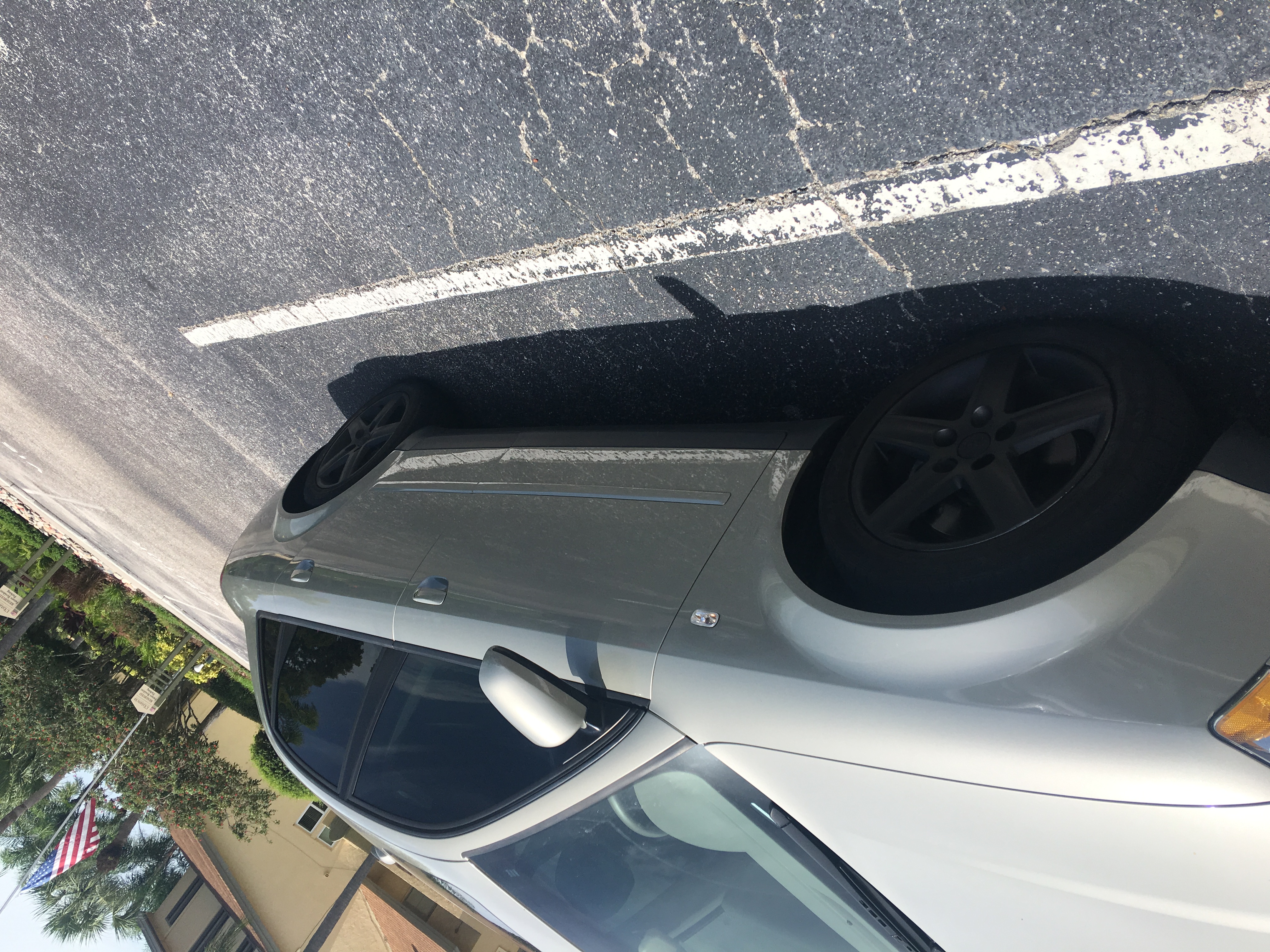

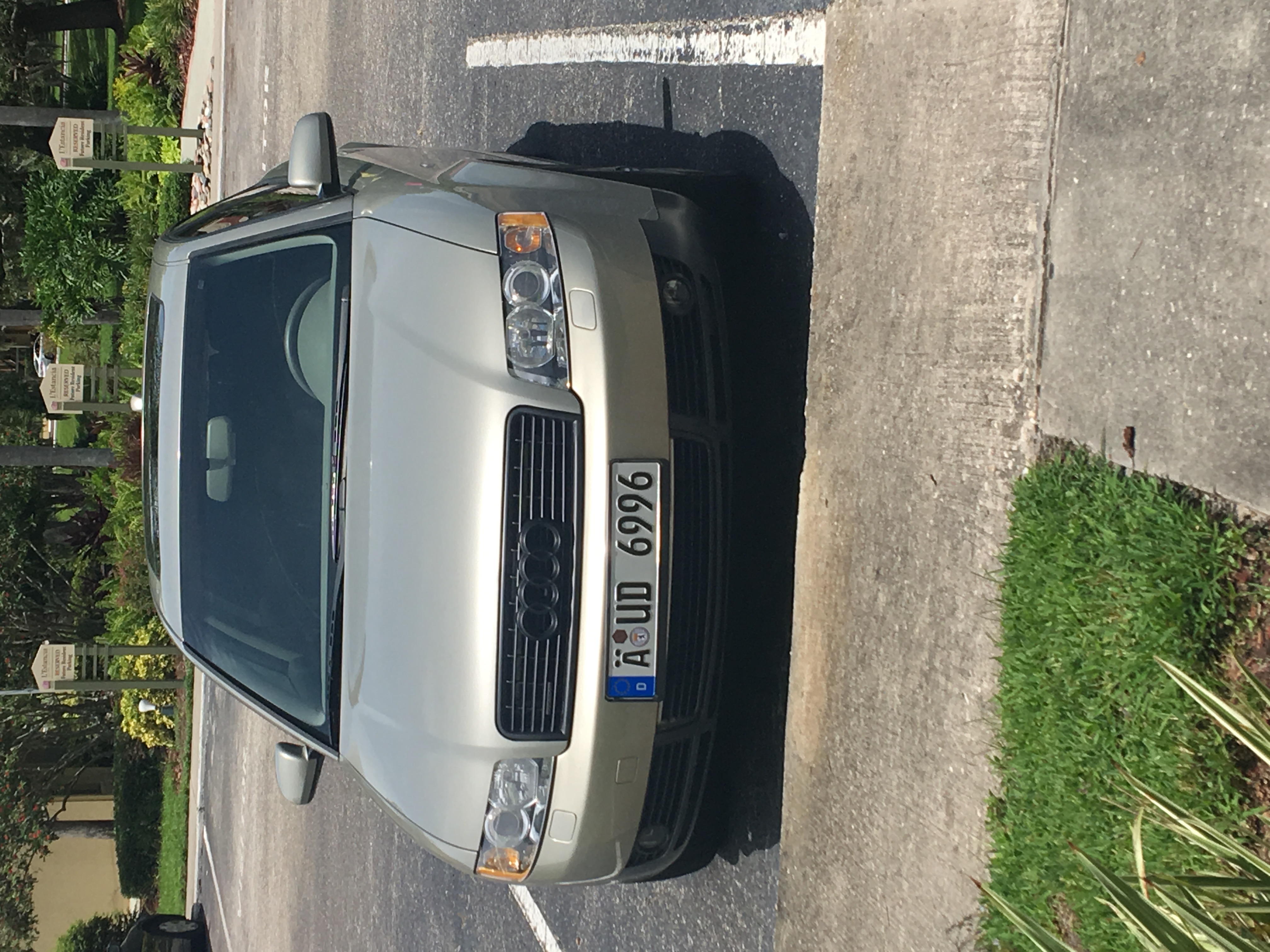

I attached some pics because she's a really nice looking car, I did all of the exterior customs myself
