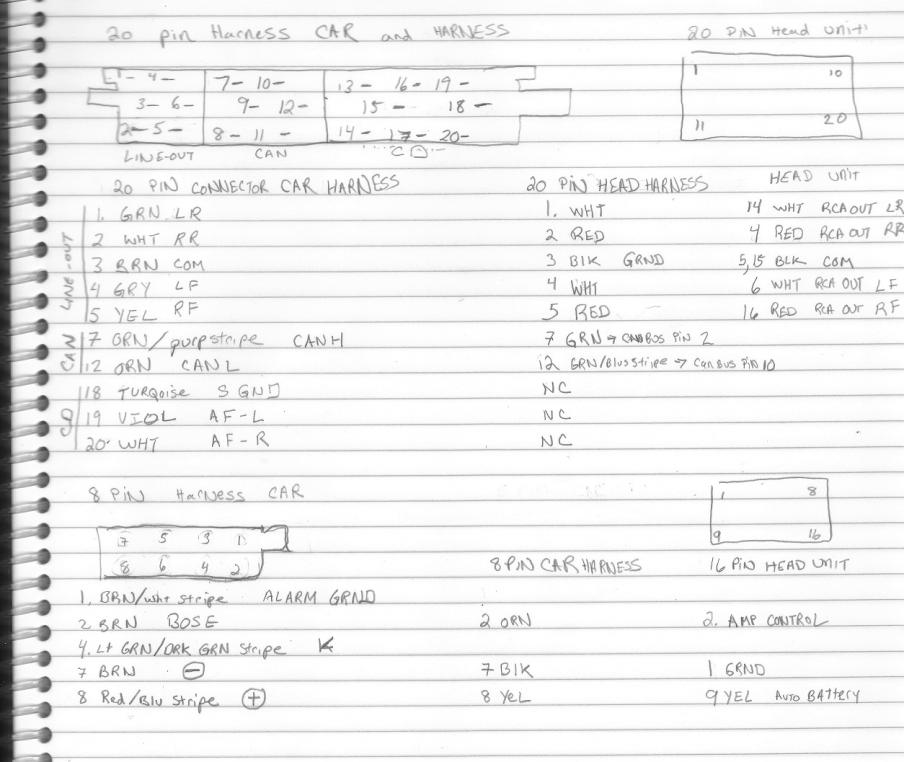

I have the same issue. No sound on my Chinese after market head unit. In addition I don't see the display on my dash. The EQ shows the radio is working Most post show the Audi as having a Middle brown connector. My car only has two connectors. I have tried using methods mentioned in here, but I have yet to solve they mystery.
Rob
Attached Thumbnails 2004 A4 Symphony HU replacement w/dvd/gps/nav-2005audia4.jpg

Default 2005 Audi A4 After Market head unit replacement
Just adding Pics
Attached Thumbnails 2004 A4 Symphony HU replacement w/dvd/gps/nav-audi-audio-schematic.jpg   2004 A4 Symphony HU replacement w/dvd/gps/nav-audi-audio-schematic2.jpg

1. Check the power cable for Bose, and confirm that the amplifier is powered on.
2. Check the harness for audio.
