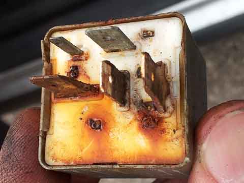

I have a audi a4 1.8t 2002 and my fans are working dying my battery when my car is not working and cold. I had a coolant temp sensor fault pop up, but erased and havent poped up again. But still the fans are working , changing speeds, when the car is turned off. I have to disconnect the fan control module from its power every time. the temp gauge seems stable and correct. Is it the coolant temp sensor or the control unit?

Relay in the ecu box for sure, ecu box under the hood next to the battery
yeah but the relay wouldnt give an check engine indication?

my relay which was used as the #219 , which labeled as 208 and the pins was trimmed to fit!! the previous owner cared much about his car!
