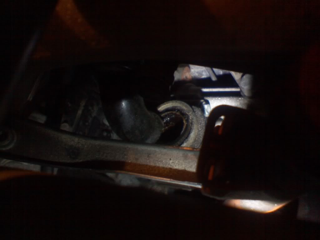

Thanks. All check valves that I have located are pristine. I have an idea where the breakdown might be. The piping off of the oil filter bracket. Possibly the "T" where the bleeder valve is. I didn't get a good look, but I saw some oily build up on that pipe that goes into the bracket.
Well, I found it. It's gonna be a bitch, but at least I know now.
It's #2 in this pic, but the end going to the "T" is female, not male.
Anybody have access to ETKA for an Audi A4 late model AMB with this kind of bleeder valve (06A103245F)?
