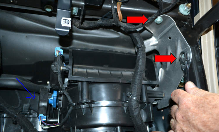

I do know that the bottom of the motor is really easy to see/check when you take the glovebox out - I took mine out in around 20 minutes last week its just a case of removing 8 or 9 bolts. Once out you can see all the servo motors and see any sticking, I think the blower has a servo motor as well - that could be sticking which is why I originally mentioned it.
here's a link with some good photos for you:-
https://www.pelicanparts.com/techart...d_Resistor.htm
and this is the servo motor i mentioned on the blower:
blue arrow showing servo motor location. ignore the red arrows....
picture is from pelican auto parts - contained in their link above.
