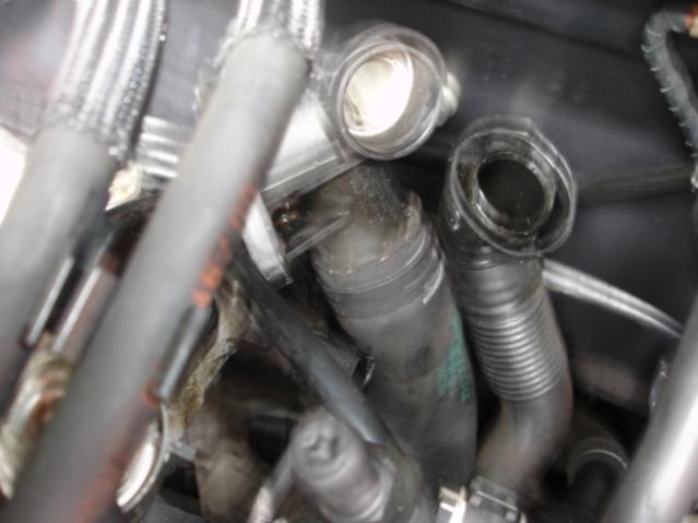

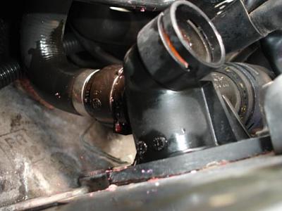

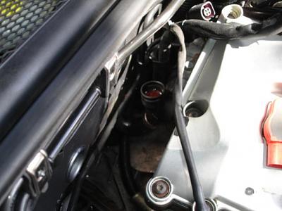

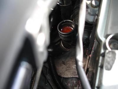

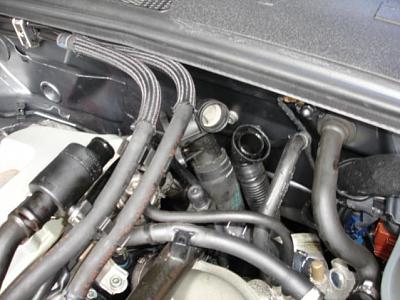

Attached are the pics for when I did mine.

Thanks all! Going to do it this weekend. Dunanga, the pics are great!

thanks for the pictures.
iam trying to this now got most of the parts out . but cant even see the bottom hose i dont know how i will take that off
anysuggestions?

For all those that are going to or thinking of going to do this DIY, this is a very fidly procedure. Certainly you need a cool head and tonnes of patience to undertake it. When I did mine what I found very important was the preparatory work. The air intake assembly has got to be taken out completely. when all this is out of the way, before undoing the clamp, squirt a bit of penetrant that does not damage rubber or silicone. then use a small water pump pliers, needle nose in this space will leave you kicking and cursing. The flange has to come off the Cyl Head while still attached to the hose that goes to the top end of the radiator (at least that is what I did). I found it easier to undo the clamp from the side where you are so close to the coolant expansion tank, as you can see in my pics above. The OEM clamps are a real pain to refit so YES I suggest for those that found this grueling, replace them with decent aftermarket ones. Tighten pretty well on refitting as these are the prime culprits for slow-leaks if left less than really-tight. It is a good thing to stick in a new CTS and retaining clip while on it. The surface where the flange attaches to the Cyl Head need to be cleaned real thoroughly before re-fitting. Assess the state of the rubber hose between the coolant flange and the metal pipe, if it is beginning to crack, replace it with a new one. Have fun with bleeding the cooling system. Eeeh eeh 3 X 1.5 litres of G12 plus plus & use distilled/de-ionised water by the way. On my 2.0L a coolant mix of between 6.5L and 7L was sufficient. I did a 50-50 ratio.
