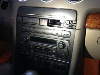

My son's Audi A4 Platform B6 2004 Cabriolet Convertible Quattro 3.0, his first car, and my first Audi ownership.
The cup holder broke, snapped off as shown. I'm having a hard time trying to figure out how to remove the old one to replace it. I google'd everywhere, one DIY was close but the TRIM removal just above the cup was much different looking than this one. I don't want to brute force anything yet. How to remove that trim? Its not a storage area, no obvious way to open it.
Any Hints from you guys would be super appreciated! Thanks.

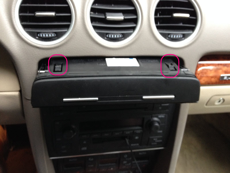

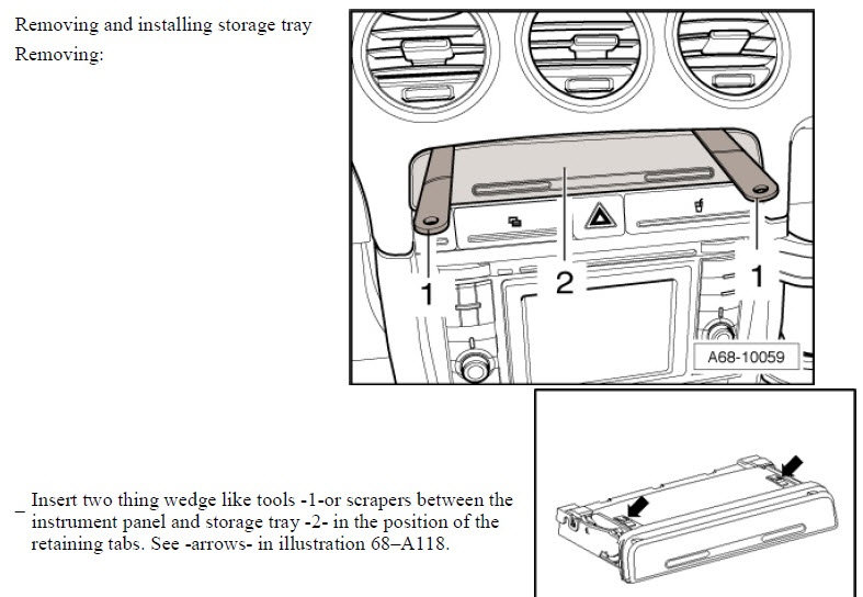

Here's my pic of the Storage trim piece on its way out, the two tabs clearly visible.
There are two related part numbers for this Storage trim part.
  1. 8H0 857 058 D USA is the non-opening version. Why Audi did this I don't know, since the part seems fully functional except for the addition of little PINS effectively making the part non-opening.
  2. 8H0 857 058 E 5PR is the one that pops open.
