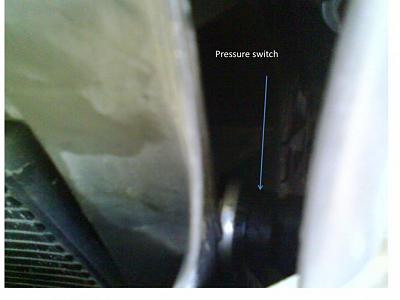

My ECON light was stuck on and no cool air was blowing out of the vents for my '02 A4 1.8T. The problem ended up being a bad thruster sensor. The A/C shop was calling it a pressure switch. I replaced the sensor for about $90. Labor and troubleshooting ran about $110. Attached are pictures of the sensor and it's location.
Attached Thumbnails ECON button stays lit and no A/C-slide3.jpg   ECON button stays lit and no A/C-slide4.jpg
So what does this have to do with this guy that had a leak from the condenser? That the ECON light stayed lit? There are a myriad of things that will cause the ECON light to stay lit, it only means that the system is currently disabled because of a problem.
