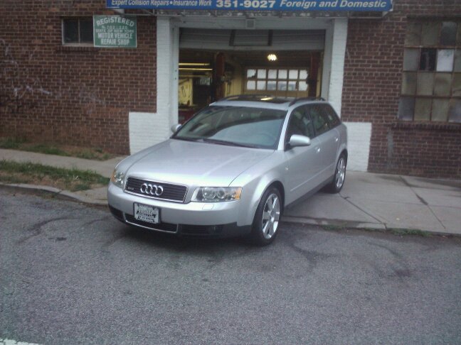

I'm new to the forum and new to Audi's in general. My car before this which I still own is a 1994 BMW 318 convertible 5 spd. I got my audi back in august with 80,800 miles on it. She runs great. It's an A4 Avant 1.8t model 5 spd. I am very pleased with it so far. I bought the car for going back and forth to college which is about 3 and 1/2 hrs away from my home. I have almost 89,000 miles on it already. I did an oil change which it called for at 84k and I'm due once again with the cam2 synthetic at 89k. I also put front disc's in her and she needs rears soon. My family owns a Body Shop so working on the car myself isn't a problem. I got a letter in the mail the other day about the engine sludge problem these cars may encounter. I'm guessing most of the people on this forum are aware of the problem. My question is... I'm just wondering what else I should be looking to replace at this point? What are some of the common things that go wrong with these cars? Thanks for the help...
