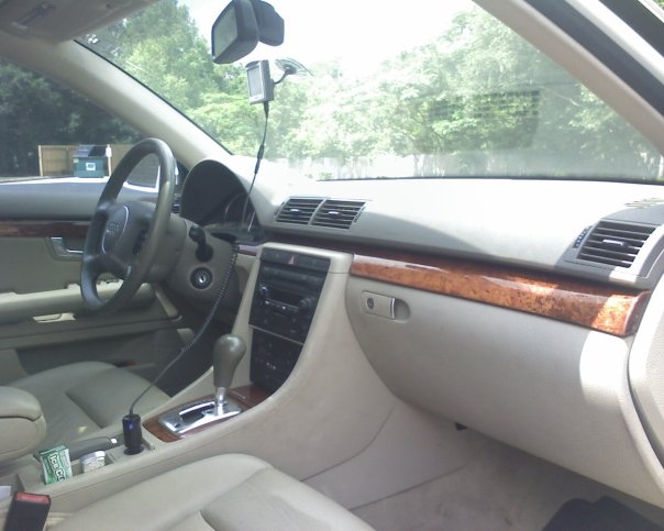

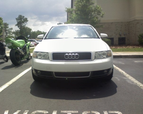

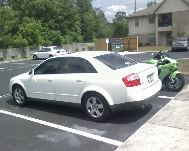

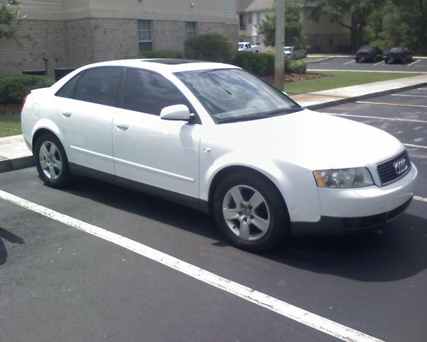

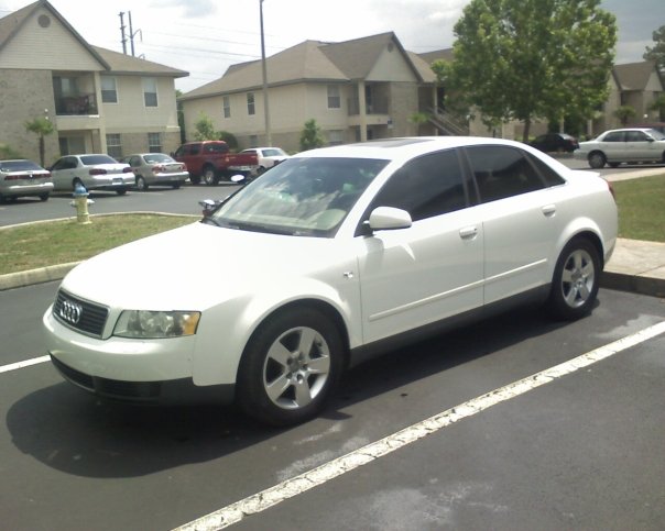

...I have been calling various places about possibly changing to a manual transmission or finding a used working TCM? I know its been a long post and I appreciate anyone's recommendation/help...Thank you! By the way, I'm attaching pics of the car to this post...to better base your decision
